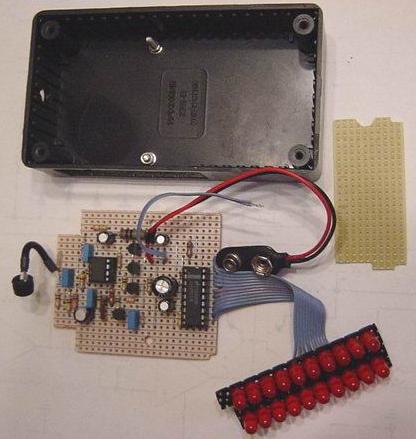

I used red LEDs and a microphone in my project:

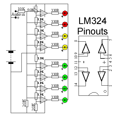

i had some problems when i tried to make this circuit, but then again, i did try to double the circuit (make 2 of them). the first one worked fine, but the second one was weird. it would display to the input level, but then the LED's would shut off until the signal started to decrease again. maybe it was because i was using 741s instead of 324s... nah that's not it I am also unsure of where to connect the speakers. but other than that, this circuit does work:D
hey thanks man, im a little confused though about where in the circuit the LM324 goes...sorry i dont know much about schematics
One single LM3915 will replace the old circuit that uses two LM324 quad opamps and millions of other parts.
