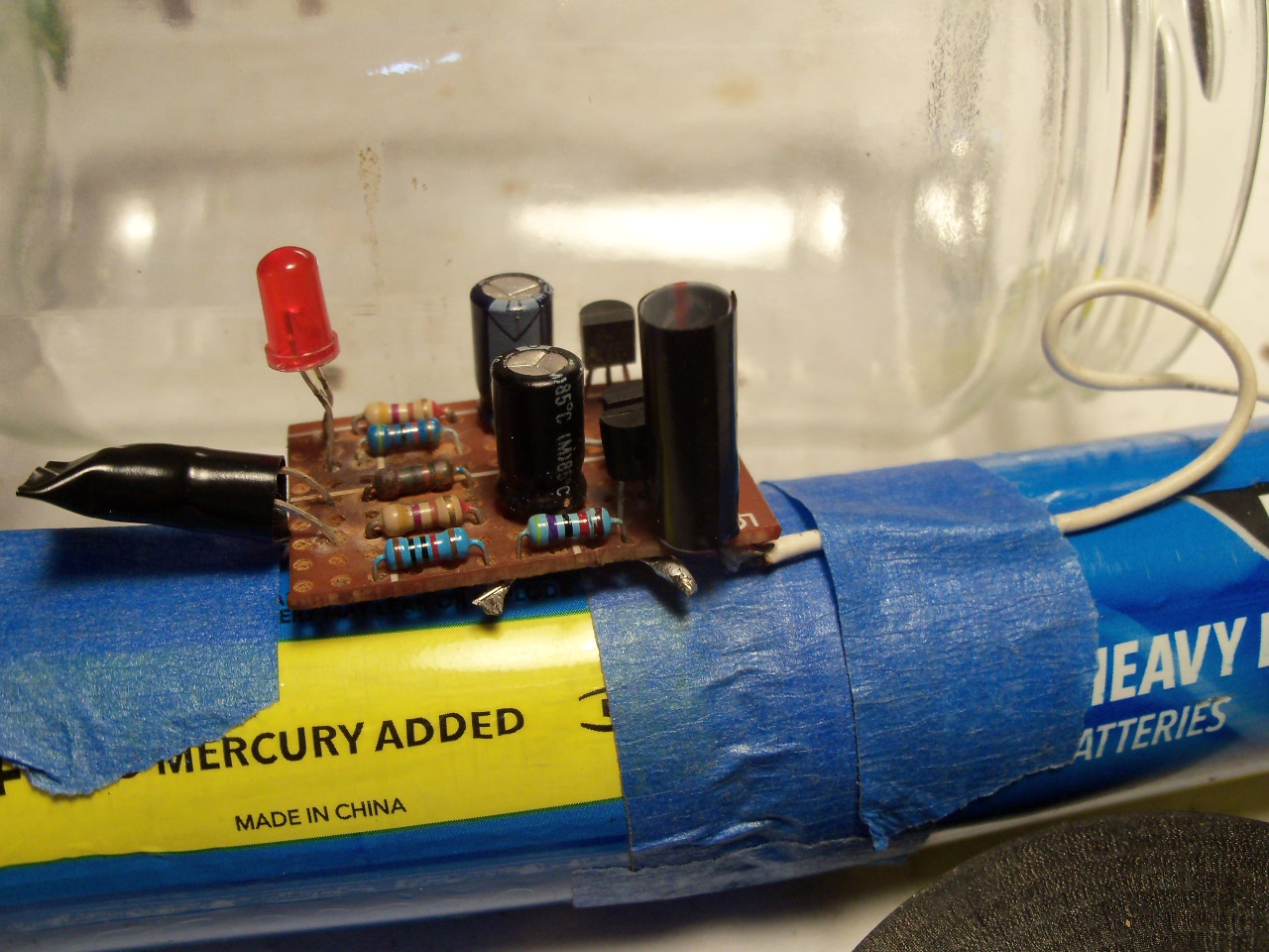

My LED lights were working good but all of a sudden they ALL start acting crazy. Several LED flashers are very dim like low battery, some don't come on at all and some 1 light comes ON and stays ON no flashing. Batteries test good several are still 3.3v same as 2 new D batteries in series. Finally today it occurred to me is must be the neighbors new LED security lights. He put up 4 lights each are 12,000 lumens. His whole yard is light up and our yard is not totally dark anymore. The 2 boys about 4 houses away from us are out of prison they have been outside howling like wolves every night at 3 am keeping neighbors awake. Last night boys were screaming like women at 3 am wife got out of bed to see what is going on and could not go back to sleep.

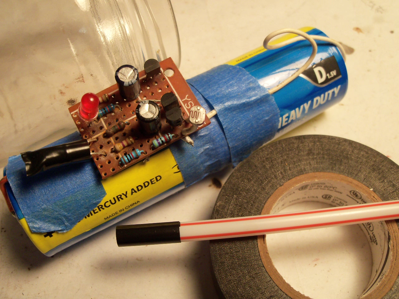

Today I did some light tests in the dark shop and decided my circuits all need stray light guards. I put black tape around a soda straw then put it over the LDR. It works perfect. All I need to do is make sure LDR look the sky and not the neighbors lights. There had been a problem with cars driving by after dark LED lights get dim for a few seconds not a big deal. Now I have all 20 LDRs looking at the sky. I put black tape over the yellow LED so it does not cause stray light problems.

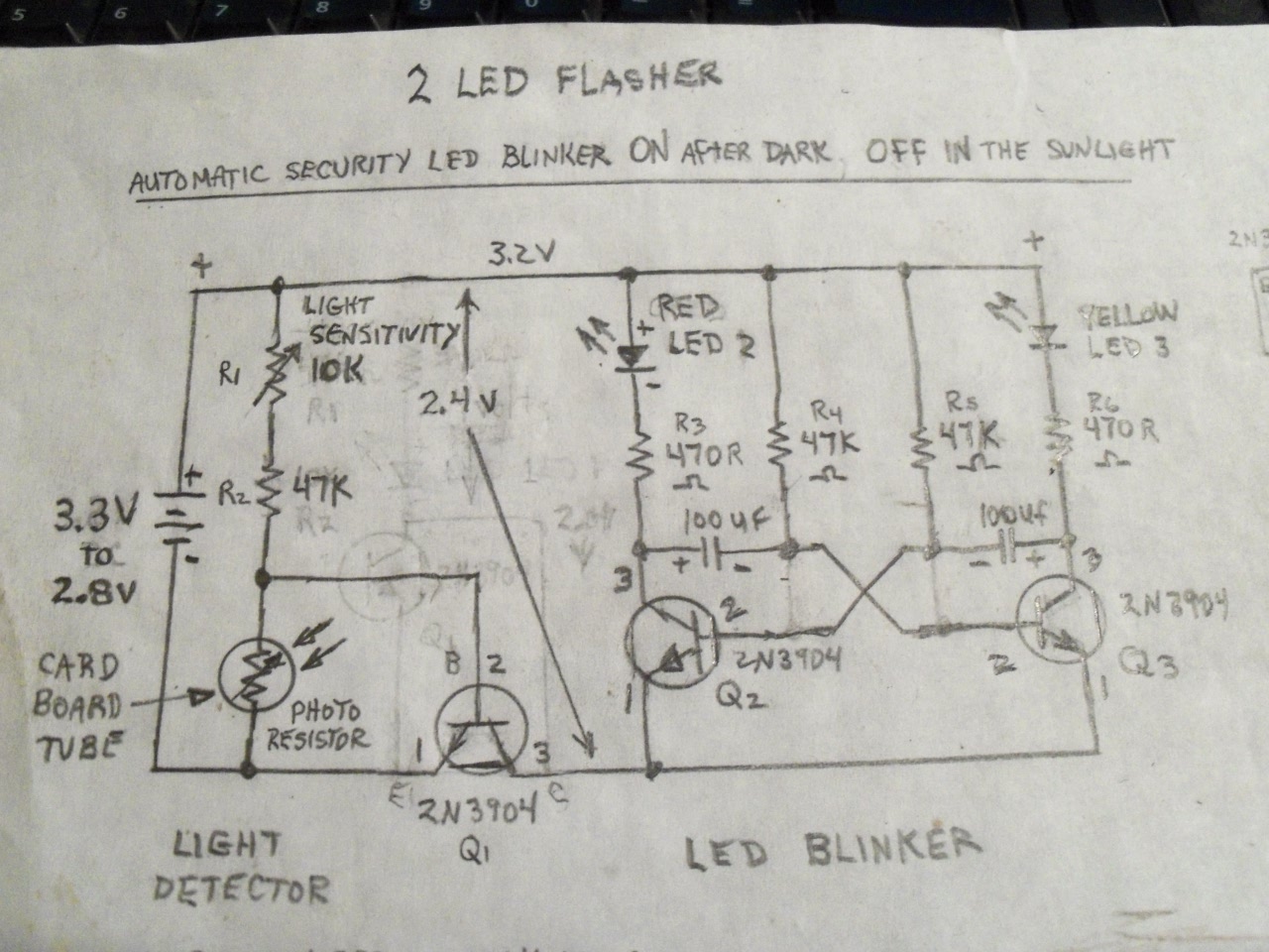

This is the circuit drawing, it has been revised several times. It will run a whole year on 2 D batteries, cheapo Dollar store batteries price $1 for 2 batteries. Circuit will not run when voltage gets below 2.8v. LEDs are the limiting factory for higher voltage. 4.5v makes very bright LEDs. I learned the trick to bright LEDs on 3.3v is 100uf caps holds a larger charge than 50uf or 10uf caps. LEDs are easy to see after dark 400 ft away with 3.3v.
When battery voltage drops to 1.35v each battery put 3 used batteries in series = 4.05v the circuit will run about 7 to 9 more months.

Thanks for the circuit. looks like an a stable oscillator triggered by the photoresistor‘s 2n3904 transistor. Robust and simple. You said you had a problem with it? In your first post you said they all started acting crazy, so you have more than two LEDs on your circuit?

This circuit has 2 LEDs. I only need 1 RED flashing LED the other LED has to be there to make the circuit work. This is a very low power circuit that is why I use it 2 batteries last a whole year. I tried several single LED flashers they use more power 2 batteries are dead in 3 to 4 months. I built 20 of these circuits they are all around our house to fool idiot thieves into believing we have a fancy security system. Thieves are stupid I guess they is why they are thieves. LOL The 2 boys that were breaking into every ones house over and over got out of prison a week ago. They were in prison about 2 years the 2nd time. When they were released the 1st time they were breaking into houses again in 2 weeks. You can't fix stupid.
