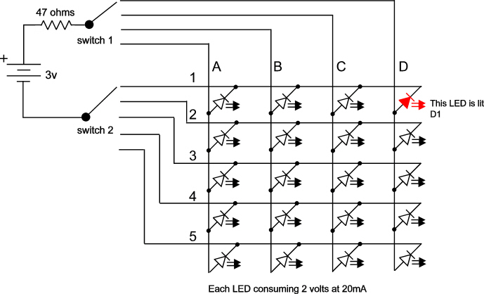

Here is a schematic showing how you can wire up the LEDs for them to operate how you've decribed. There are two rotary switches to select the column and row.
Here are links to a few rotary switches that will work for your project.
5 position rotary switch: R20507RR02Q C&K Components Rotary Switches
4 position rotary switch: MR-14-A5 Well Buying Rotary Switches
The 5 position switch has more connections than you need but it will work for you and was actually cheaper than the version that only had the required number of connections.
For a power souce you can use 2 AA batteries in series. This will give you about 3V with fresh batteries. The LEDs will dim as the batteries are used up but they will remain plenty bright for most of the battery life. With normal alkaline batteries, you could run this thing for days before the batteries die.
Good luck with your project. Post back if you have anymore questions.

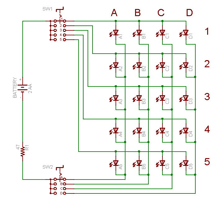

I was an idiot of my initial idea, it should have been more obvious to me...
Dang, beat me to it vne147!

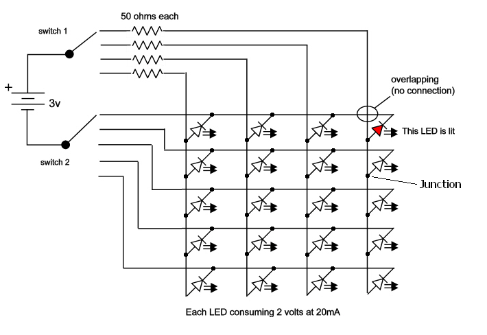

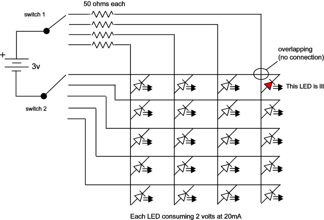

We pretty much came up with the same circuit except he only needs a single resistor wired between the common pin of the 5 position rotary switch and the negative terminal of the battery. Or instead, he could use a single resistor wired between the positive terminal of the battery and the common pin of the 4 position rotary switch. Six of one, half a dozen of the other.
Also, 50Ω is the correct caluclated value for 20 mA current, 3V supply voltage, and an LED forward voltage of 2V but I went with 47Ω becasue it's a more standard value and it will also allow the LEDs to stay brighter for a little longer as the battery voltage drops over the course of its life. The 47Ω resistor will allow about 21 mA current through the LEDs with fresh batteries but that will be just fine.
EDIT: Also, this is just a suggestion but for future reference if you place junctions at the overlapping wires that should connect, it won't be necessary for you to point out the overlapping wires that shouldn't connect. Like this:
The updated attachment should work...

Thanks so much for your help guys! I just finished building the circuit and it works like a charm! The only thing left to do is to connect the wires from the array to the switches, and from the switches to the battery pack.
As a preliminary check, I went through and tested the LED's directly on the array, and they all power on just fine. But when I try to put power through each of the 10 foot wires leading to the array, I get no such result.
I'm using regular telephone wire, which is 6-conductor and stranded, and not getting anything to light up.
Any suggestions? I think I might need to move to a solid core.
P.S. Thanks a ton for the suggestions vne, I will check Mouser out.

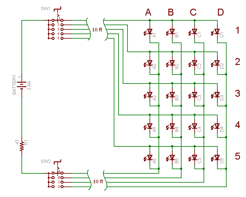

Let me make sure I understand what you're doing. You are planning on seperating the batteries, resistor, and the switches from the LEDs by 10 ft. Is this correct? Like this:
I wouldn't have expected the voltage drop along 20 ft of telephone wire to be large enough so that the LEDs wouldn't light. To check and see, measure the resistance of 10ft of the telephone wire. Check each conductor to see if the resistances are the same. Post back here with the measured value.
Your schematic is right on the money. And your right, neither did I. But give me a minute, and I will go find those values.
***Actually, nevermind. My multimeter just ran out of juice. But I can go ask one of the physics teachers to use one at school tomorrow and post the values sometime around lunch. (During my break of course)
