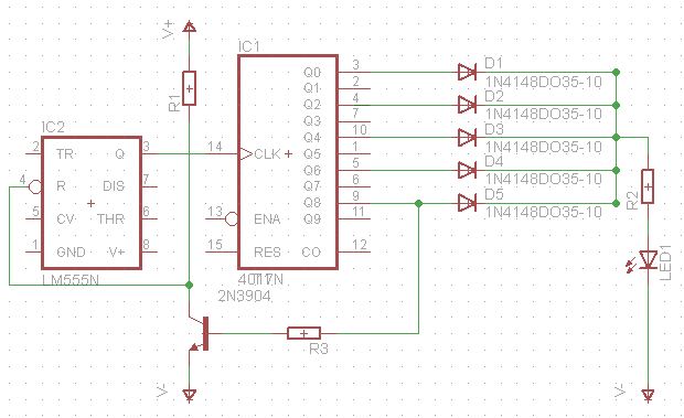

Hello. I have been assigned a task of designing a brake light with the following specifications:
1. The circuit shall start when given voltage (Obviously!)
2. It must be operational within 10-16V.
3. It must blink 5 times, and thereafter light continously.
4. The Blinking frequenzy must be approximately 5 Hz or similar frequencies appealing to the eye.
5. As the system is designed to replace current brake lights the only signal coming from outside the circuit is the 12V from the car.
I tried sending a 5 Hz test signal into a CD4017B decade counter. I thought i could then take every second output into an or gate made up of diodes a transistor and resistors. I thought this would give the five blinks and that connecting the last output leg to the clock inhibitor would then make a continous signal after the five blinks. The circuit would be resettable by coupling the voltage off. The final circuit would then be made up of an NE555 delievering the 5 Hz.
But the problem is that i have hooked up the decade counter as i mentioned on a test bench, but i am only getting a high low shift on the legs of the decade counter and not on the rest of the diodes that only show a low signal. I thought this would work. What am i doing wrong and could i possibly add some pulse width modulation to make the circuit more efficient?

5 hz is still quite fast--connected directly to this signal, an LED would blink 5 times in a second. Even taking every second output from the 4017 would give you 2.5 hz, which is still kind of fast to call a "blink pleasing to the eye". For that, I would suggest, maybe, 0.5 hz.
Could you post a schematic of your circuit? It's possible it is just a simple mistake in the wiring.

I would as DerStorm suggest slow the clock down to about .5 Hz. You should be able to use the 4017 with every other output configured as a Count To N and Halt by placing pin 13 (clock enable) on N. Also, yes posting a circuit would be cool.

I never will. That would almost equal a suicide attempt. Anyway. Do you see any reason as to why my circuit shouldn't work? I had it set up on a test bench and applied a clock signal i then tested for logical low and high with the test bench and the outputs on the 4017 do vary but after the diodes everything is just logical low. Thanks.
Your diagram is slightly difficult to read, as it has some parts that are not drawn in standard form. It is difficult to tell which wires are connected and which aren't, but overall it looks ok. Next time, try drawing your circuit in a program such as . Also, try to learn some of the standard conventions for circuit design, as they will help you a lot in the long run ;)

Your circuit has the Reset pin 15 floating on the CD4017 instead of connected to 0V.
You should add a "power-up reset circuit" so that the CD4017 is reset when its power is turned on.
You have two resistors powering the LED instead of just one.
Looking at your cartoon (quite good for using paint) I think I see a problem. You want the 4017 to count to N and halt. Now the 4017 will sequentially make each output high while all the others remain low. You will inhibit the count by making pin 13 high. The way your drawing looks using pin 11 (output 9) to inhibit the count when out 9 goes high all the other outputs will be low. The count will stop with all outputs (except out 9) low. I think you would want pin 13 tied to output 8 pin 9 to get the effect you want. The 4017 will also drive small LEDs direct without the need for a transistor. Not a bad thing I just see no need. Also it looks like outputs 4 & 8 go through a resistor to ground? I don't get that part.

EDIT: I just took another look. I'm sorry if someone already mentioned this, but the way you have it set up now is that the LED is connected directly to +V through two resistors. The way you have it now, you'll always have some power going to the LED, and you don't want that. Also, we really need some resistor values. Without them, it's difficult to say what exactly it will do.
..... the way you have it set up now is that the LED is connected directly to +V through two resistors. The way you have it now, you'll always have some power going to the LED, and you don't want that.
The resistor connected directly to the LED is not needed and can be replaced with a piece of wire. Then you can see that the LED is turned off by the transistor shorting it which wastes power if important.
I just took a little bit of time to throw together a basic schematic showing how things should be connected. I did leave out some of the main circuitry, assuming you know how to connect a 555 in astable, and the basics of the 4017. I also left out the reset-upon-power-up that AG suggested. This is just the very basic version. Keep in mind this is not complete! You will still have to do some work. This is just showing how to connect the LEDs to the 4017 through diodes, and how it stops on the last LED. When the last output (and LED) turns on, it causes the transistor to conduct, holding the 555 in reset. As long as it's in reset, the timer will not run. You'll need to put in the power-up reset circuitry yourself. Since this is a school assignment, I really shouldn't show you any more than this. Do some research. Google is your friend--you'll learn a lot about how these chips work.
