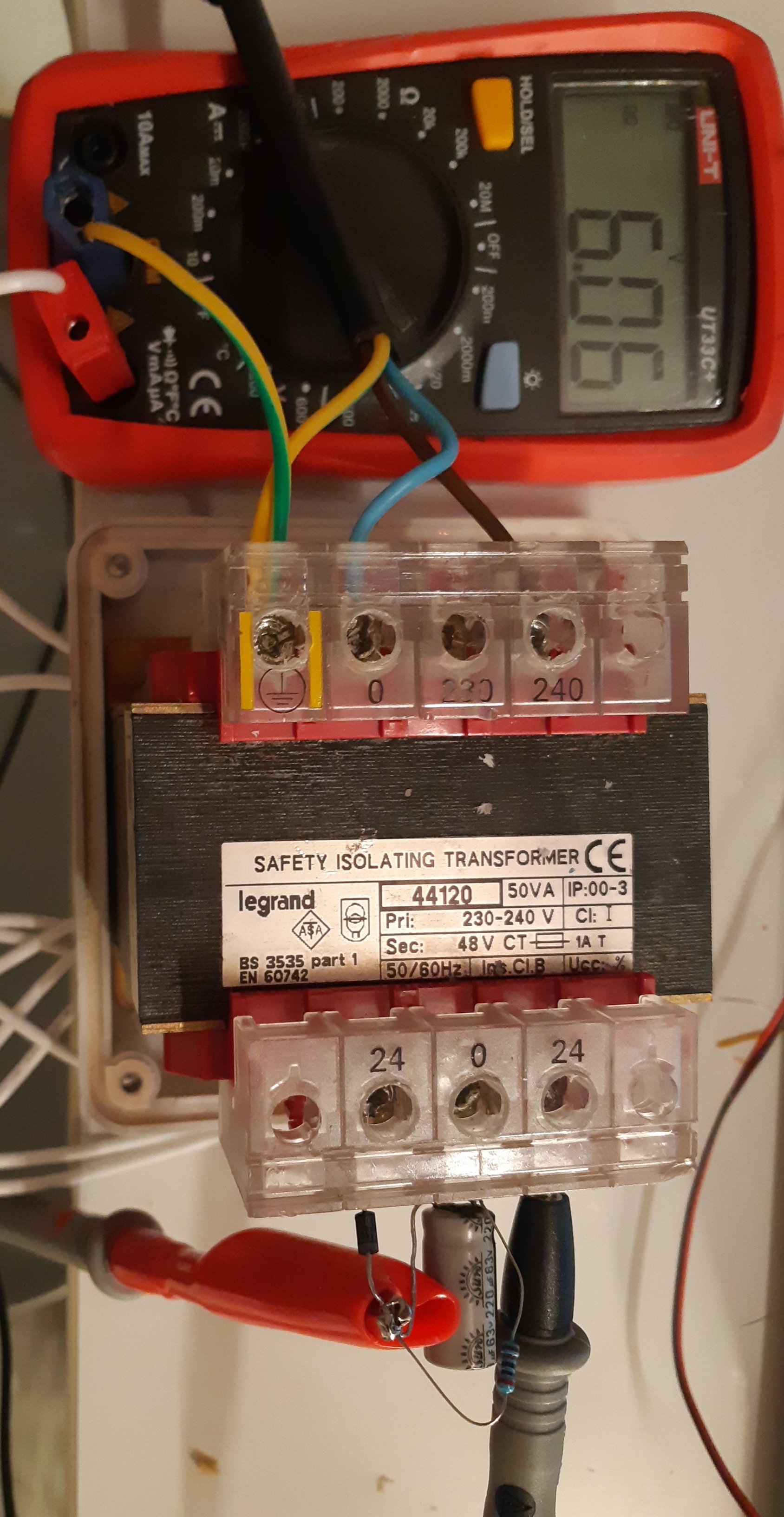

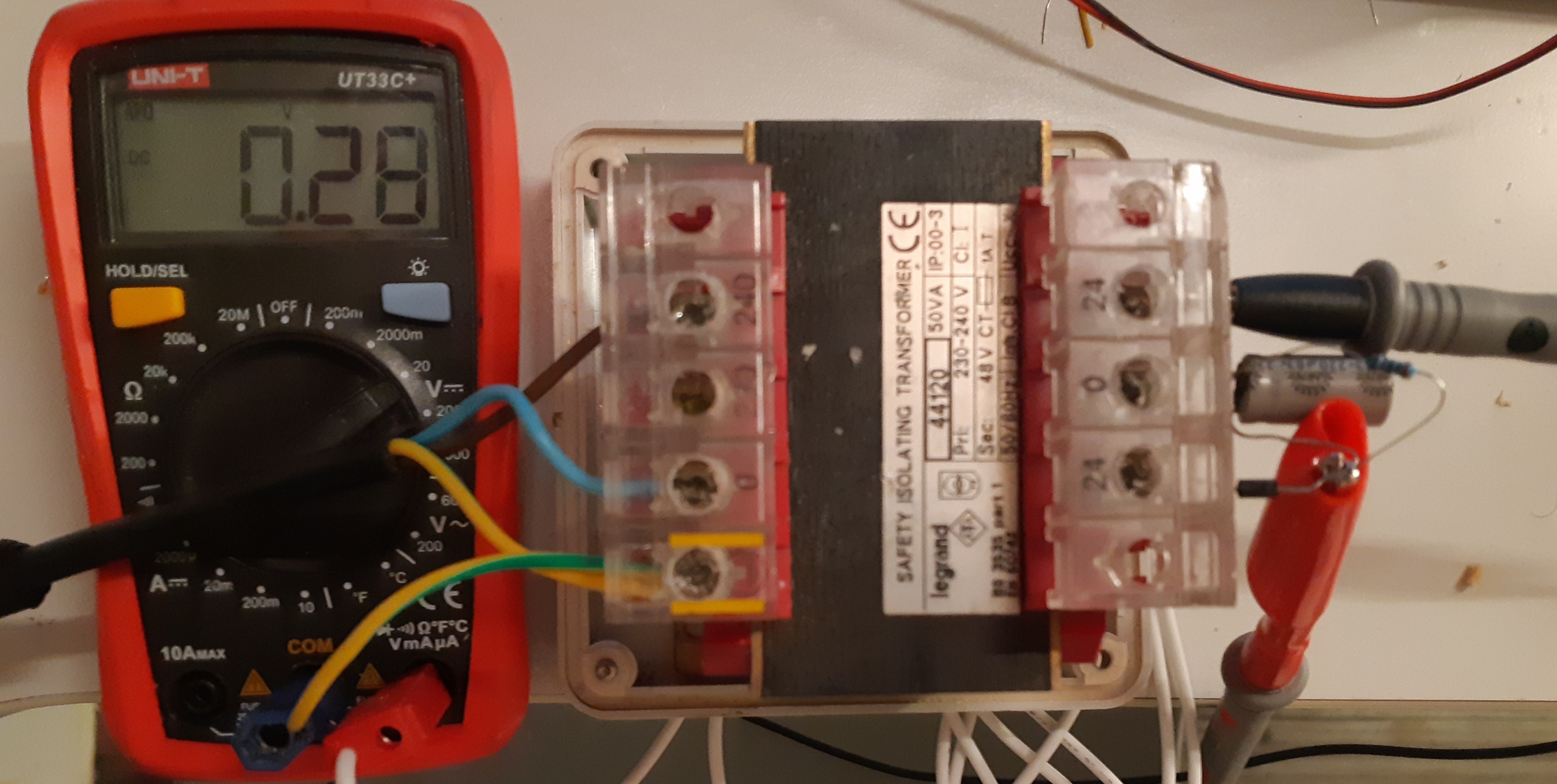

I was using my isolated high-voltage supply earlier and I had this strange issue where I would feel tingling upon touching some other part of the circuit and the earthed metal case of the supply simultaneously. When I connected the probes of my battery-powered handheld digital multimeter between the highest voltage output and the metal case with the supply turned on I measured just over 100 volts DC. I was able to finally narrow down the issue to my bench top multimeter (Fluke 8010A). Removing the bench top multimeter dropped the voltage down to under half a volt. I can measure around 100v DC between the metal enclosure and the isolated DC output of the supply whenever the bench top meter is connected to the circuit regardless of whether the meter is powered on or not. I can actually turn off the outlet and as long as the meter's ground pin on the plug is connected to earth I will get this voltage. I can even measure the same voltage when a single probe from the bench top meter is connected to the 0v output on my supply. It seems like there's leakage current between the meter's inputs and mains earth.
I measured the resistance between ground on the plug and the negative input of the multimeter and it was greater than 20M ohms (my handheld DMM cannot measure above 20M ohms). Any thoughts on this? I can probably get access to a PAT tester on Monday if that would help but I really did not expect the multimeter to fail this way.
The multimeter almost certainly hasn't 'failed', it sounds like it's working perfectly.
There are two types of mains appliances, Class I (earthed) and class II (not earthed), the meter will be class II, as an earthed multimeter would be a VERY serious safety hazard.
Because Class II devices aren't earthed they can gain a high static charge, to prevent this there are special safety components connecting from chassis to the incoming mains - these are usually a high value resistor and a capacitor in parallel, and are vitally important, and drain the static charge to ground (via the mains).
The result of this is that the chassis of the appliance floats at about half mains potential, as a VERY low leakage current, hence the small tingle you can feel.
Perfectly normal, nothing to worry about - and certainly something you shouldn't try and 'cure', as you would be making it dangerous.

Thanks for the respone. The multimeter itself has a plastic case and I've never had any issues using with the meter itself. The issue is that when the multimeter is used to measure voltage coming from a different supply with a grounded metal case current seems to be finding a path to earth through the multimeter's inputs. Normally I wouldn't be able to measure any voltage greater than half a volt between earth and the supply's outputs but with the meter connected to the supply I can measure 100v DC between the supply's isolated outputs and the earthed case. This seems to indicate the meter is affecting the isolation between mains and the supply's outputs. Is this actually a problem or do you think it is probably something that can be ignored? I assumed that the inputs of the multimeter are completely isolated with no way for any measurable current to flow to earth through them.
