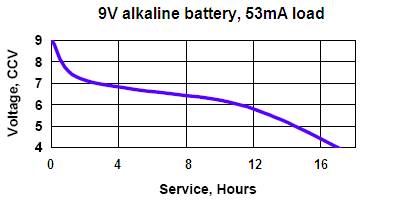

A battery voltage drops as it runs down. Therefore the LED (not lead) will get dimmer and dimmer. Transistors or an IC can be added to keep the brightness constant.
A 9V alkaline battery voltage drops to 6V in about 16 hours when it starts brightly with a 40mA load. The voltage drops quickly when it is less than 6V.

Like I said, look at the datasheet for a 9V battery on the website of a battery manufacturer like Energizer.
The datasheet show curves of the battery voltage dropping at a certain current.
The voltage drops quicker at higher current.
Here is a 9V alkaline battery with a 53mA load and with a 400mA load:

On the datasheet for Energizer's 9V alkaline battery there is a graph showing mAh from 625mAh when the current is 25mA to 300mAh when the current is 500mA.
They have a graph of how long it takes for the discharging battery voltage to drop to 4.8V and 6.0V when the load resistance is as you select on the graph.
They have a graph of how long it takes for the discharging battery voltage to drop to 4.8V and 6.0V when a constant load current is as you select on the graph.
They have graphs showing the voltage dropping with time when the battery powers a 620 ohm radio, a 270 ohm toy and a low current smoke detector.
