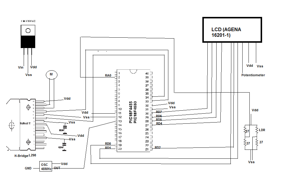

project of PIC18f4550 used LDR sensor to control the blind(window) open or closed using DC motor
see this link where the schematic draw for this project
i didn't studied the microcontroller
so i hope you help in programming the project
Big pic for such a little job. You don't need a 48 Mhz crystal 20 would be fine. You'll have big problems with a 48 Mhz crystal
if you can't make a proper PCB for this. And a 18f4550 can't use a 48 mhz crystal any way it uses a 20 and Pll to get 48 mhz
But you don't need that if your not using USB.
I have a program that would do this but it's in Swordfish Basic
