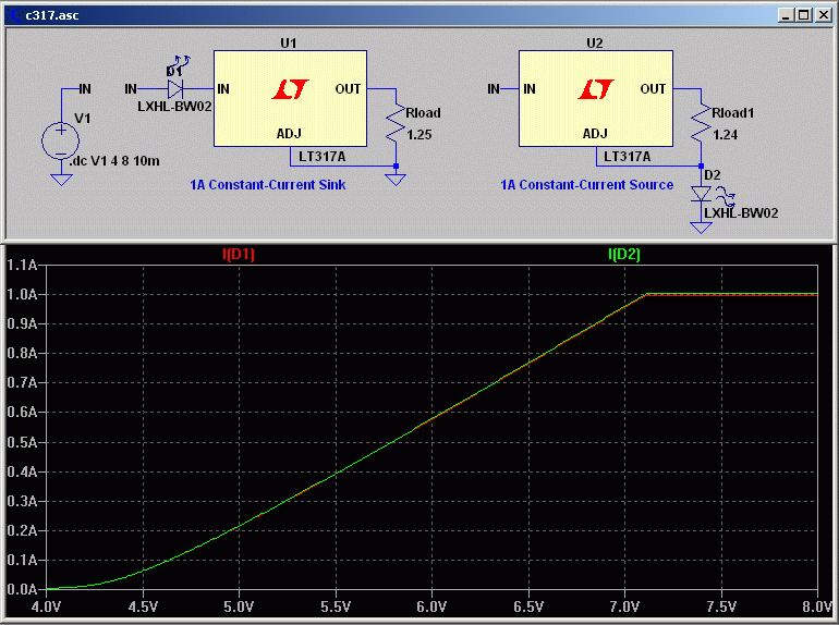

Here is the simpler '317 used as either a current source (high-side) or a current sink (low-side). The current through both LEDs vs the input voltage V(IN) is identical. Not a particularly good constant-current LED driver because the input has to get to 7.3V before either circuit regulates...

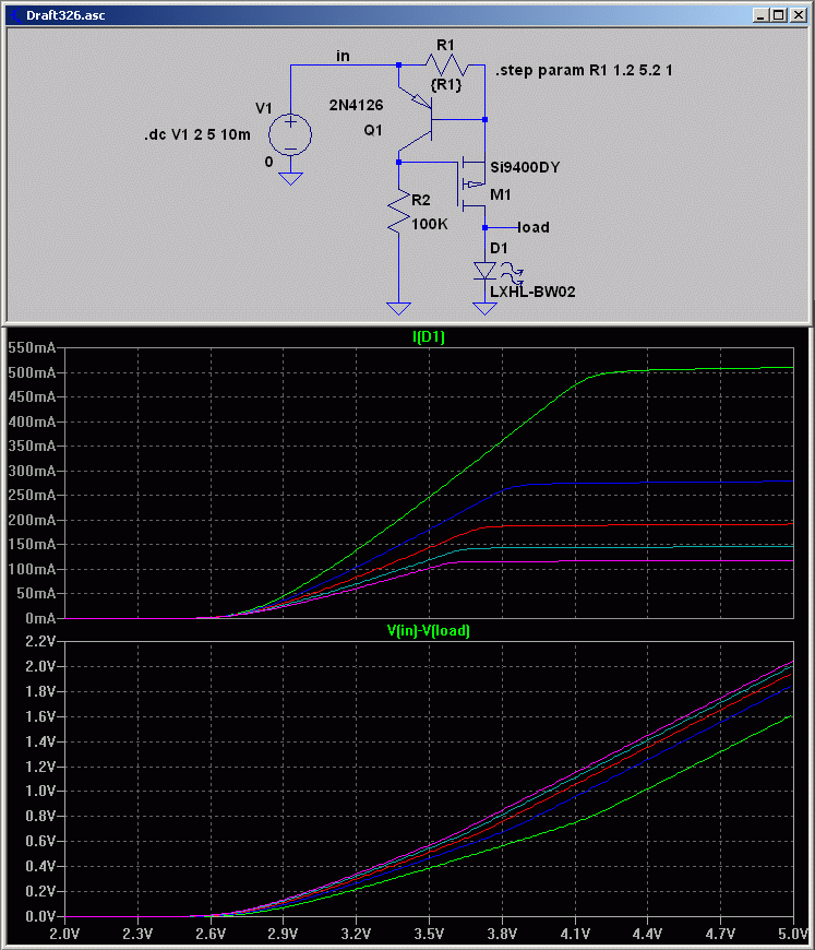

Here is a high-side current-source that has Vdo=V(in)-V(load) of ~0.8V for a range of load currents.

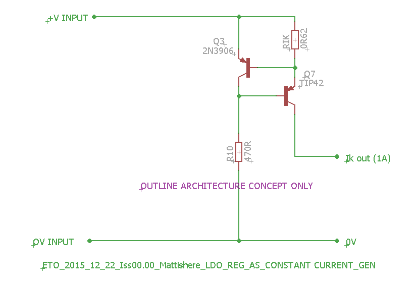

You are making a rod for your own back by trying to make an LDO constant current generator from an LDO voltage regulator because, by definition, you have the VRef plus the DOV in series with the input supply rail.
There is a proper way to do the job. The schematic below shows a rough and ready constant current generator of around 1A with a dropout around 1V. This illustrates the principle.
The proposed constant current generator can be configured as:
(1) High side +Ik
(2) Low side +Ik
(3) High side -Ik
(4) Low side -Ik
If you post the following data, I in return, will post a simple circuit, using a few cheap and readily available components, that will meet any reasonable requirements
(1) Input voltage range
(2) Value of constant current
(3) Accuracy of constant current
(4) Definition of load
(5) Maximum acceptable dropout
