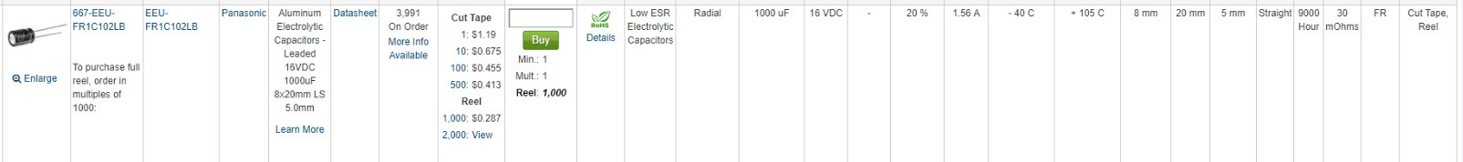

Ok so I measured the little bugger best I could:
Part: Leaded Electrolytic capacitor
Diameter: 8mm
uF: 1000 uF
Temperature: 105 celcius
Height: 20mm
Pin Distance: 5mm
Voltage: 16V
Brand: <BH>
Polarity: TBD
So how would I ensure I get the right part and size?
Mouser or Digikey looks cool but I get lost on the first menu for filtering.

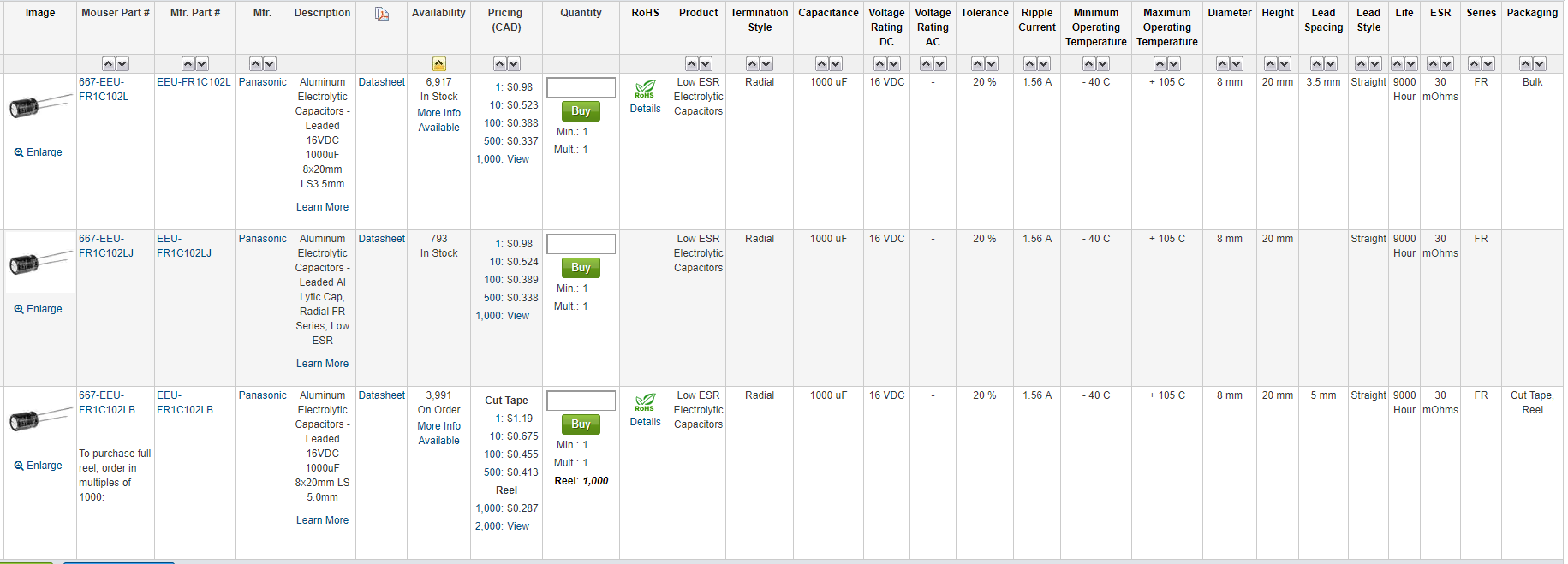

I took a stab at it, does this look right?

Does this help?

You need not enter all search criteria in at the same time. Enter the most important things and filter. It will remove narrow down and remove search criteria that aren't available for products based on the previous search criteria you already used.
The third one seems to have the proper lead spacing. The first one does not and the second its not listed for the second one in the search database (which means you have to check the datasheet but capacitor datasheets are overwhelming if you're starting out since a single datasheet covers multiple sizes and models, all with slight differences and only discernible by a vague code. The simpler the component, the more complicated the datasheet is the way it usually goes.).
If you use the search enough you learn not to always trust the search since sometimes information is entered in or are classified incorrectly, or not classified so they dissapear when filters are applied when they should appear...but let's not worry about that for now.
The third one seems to have the proper lead spacing. The first one does not and the second its not listed for the second one in the search database (which means you have to check the datasheet but capacitor datasheets are overwhelming if you're starting out since they cover every model available in that line)
yeah, i forgot to look at spacing column. So looks like #3 wins.
Looks good to me. Might want to throw some extra stuff like a few tools into the order because $1 capacitor for $8 worth of shipping through the mail seems like a waste.

I plan to take these specs across to the Chinese mall here. There's a guy there with a bunch of old electronics and he may be able to easily source this part. will see. thanks everyone!
That works too. It's not a very special part.
