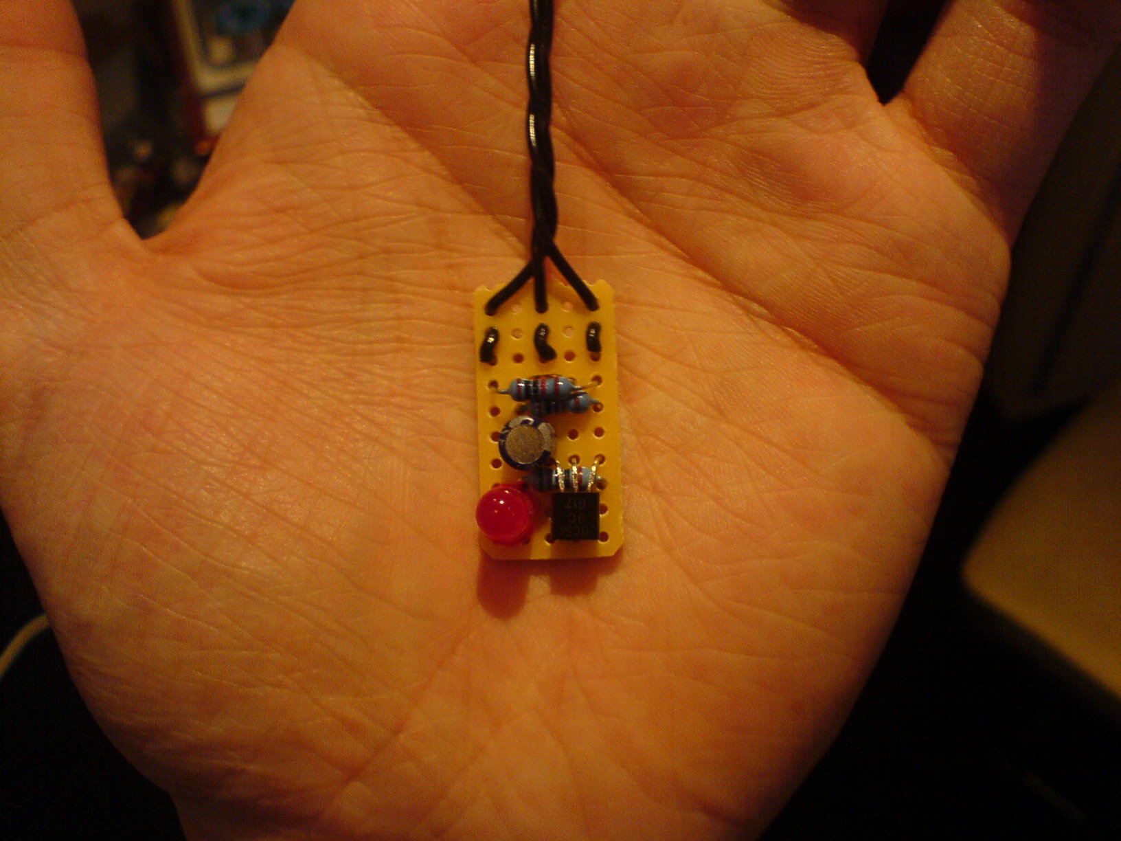

Also on a different subject - I'm looking for ideas on ways to prototype. I usually use a bread board and then strip board. Attached is a recent project which was done on a strip board which has come out very small and quite cute, but there are probably better methods.
I currently have a 20x4 LCD plugged into my breadboard with a pin header but I'm worried that when I remove it - The holes won't grip wires very well.
In another thread, it was suggested to make PCB's of common circuits and connect them together with wires, saving on re-building the common circuits and also saving breadboard space, but what other methods are there ?

Your tutorials are what sparked off the idea of pre-building common circuits on PCBs. The problem with vero board is that it's expensive and you have to use quite large boards. Have you had any experiance with others and if so, why do you choose vero boatd over them ?
I've never made PCB's, Veroboard is pretty reasonably priced, and much faster to use, without all the ancillary gear needed for PCB's.

I make all my projects with SMDs. I use 0805 size exclusively. Never tweezers! They snap! and where did it go? I use flux and an Xacto knife to delicately place the component. then carry a little solder on the iron, deftly hold the part down with the knife and hit with the iron. Seems to work for me. Clean knife often with alcohol. Headband magnifier - Yeah!
PC boards are reasonable. I use ExpressPCB. Software is free, works great. and you get three boards for $61. I put several projects on one board, so i get several projects out of one purchase.
