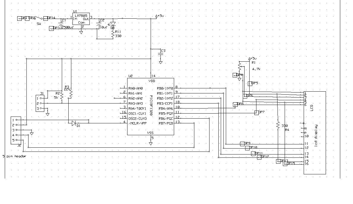

Have checked and rechecked all my connections but still no "HELLO WORLD"
What am I missing? Sorry if I posted code wrong?
ANY SUGGESTIONS for this simple task?

You can't put LCD.WriteAt(2,1,Convert.DecToStr(Variable,5)) It's LCD.WriteAt(2,1,DecToStr(Variable))

You forgot to Include "utils.bas" // Your need this to set Digital with SetAllDigital //????? set's pins to output

do you have mclr pulled up to vdd with a resistor ? I no the code works I even posted a video showing you what it looked like
The grd and Vcc on pin 3 of the LCD was not connected (I started on this board about 8-10 months ago and just now getting back to it)
I connected missing connections, adjusted the contrast and BAM I have text!!
THANKS
