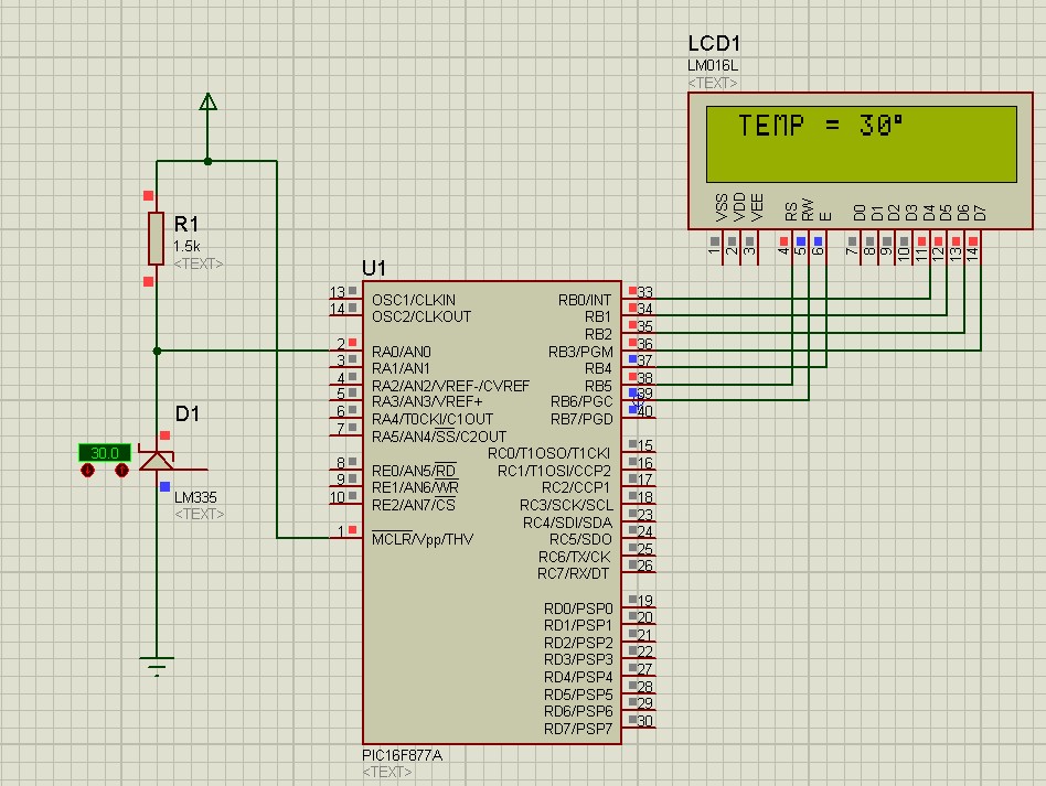

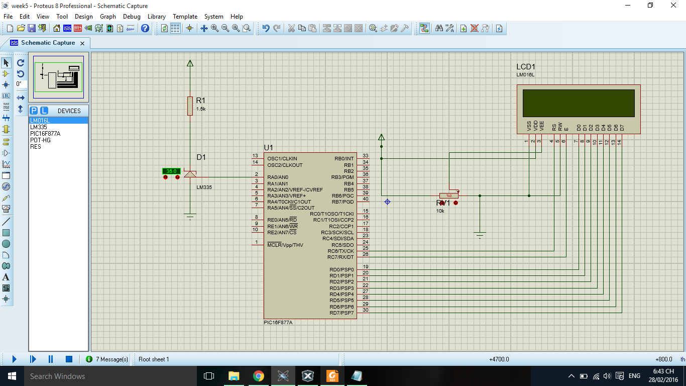

Below is my code and my proteus project screen shot

For a start I cant see a LCD initiate function, this needs to be called once at the start on main. There are other problems but its a start for you.
You have no power on the LCD and the contrast (lcd pin 3) needs a pot or tying low.
MCLR pin needs tying hi via 10K resistor or it will sit in reset, also not sure what the start default is but I would declare if the MCLR pin is on or off (recommend on).
You have a HS OSC selected in code but no OSC on the drawing, this is full of **** you need to sort the simple things out first, I get the feeling you have done little study in this.
Go through the drawing and match it to the code, you clearly have not done this.
Sorry if all that sounded grumpy, it wasnt intended to be grumpy. Have another go and repost your results people will help you get it done if you do the work :D

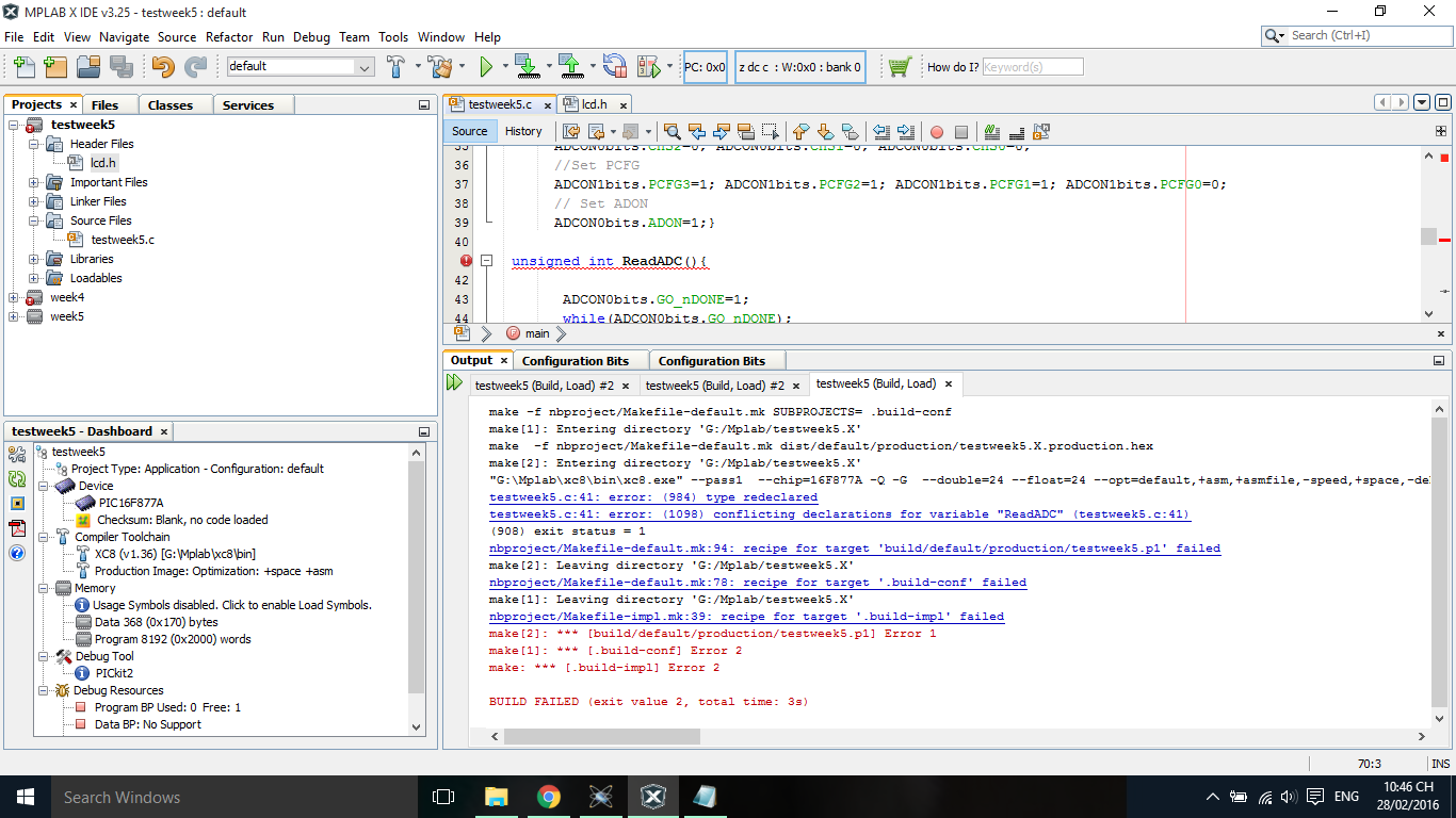

Updated !
But still wrong
Error screen below

Ok go with what your teacher says, I dont use proteus much or 16F chips, the code i gave you sets the internal OSC for a 18f chip, if the 16f dosnt have internal OSC it will need the code changing. I gave you the code for the LCD routines not the setup. Look at page 145 of the data sheet, you still dont have the MCLR pin tied so you might be sitting in reset. put a message early in the code to display on the LCD, that way you know when you have that bit working, then you can sort out the ADC for the temp sensor.
Looks like the codes have something to do with problems to the ADC, respost the code you have in full. I am on and off today so might be a while until I can answer, dosnt help that I dont use the same compiler.

And circuit (Running)

So in proteus you can leave power pins unconnected?? For a sim that seems a bit odd. Does the MCLR have to be tied in proteus?
I notice its the same with the OSC pins.
I didnt realize you were so short on time! do they normally only give you a couple of days to do it?
For proteus to sim as fast as possible... You leave anything analogue out of the equation.. MCLR is tied to 5v on chip that need it... resistors are only needed for pullup purposes... There is a special pullup model..
