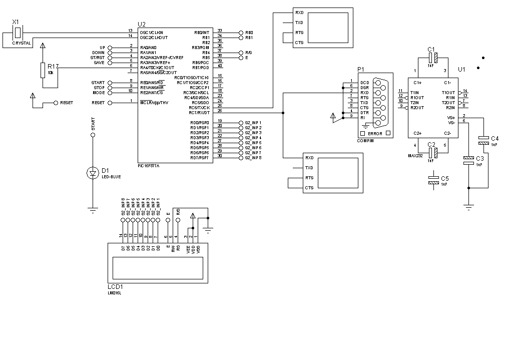

I've got a 16F877A reading serial data from a digital multimeter. The DMM data can be read using HyperT on the PC; the idea is to try using ucontrollers to decrease costs and try to display the available data on a 2x16 LCD. So far I've got a simulated circuit on Proteus and a physical circuit from a previous project. The current problem is this:
In the Proteus circuit, whenever I start the read, the LCD never reads the entire data being sent, just the first few characters. For example, suppose that the data has a format of +0000.32 DV. On HyperT the data is fully shown, but the LCD will only display '+00', then hangs.

I once tried changing the code a bit so that it reads and echoes keyboard chars, and the LCD works. If I press the keys one by one, it displays just fine. However, when I press the keys really fast, the LCD freezes again. I suspect the PIC didn't have enough time to read each cahracter being sent and this freezes up the PIC. Might be wrong though. I attached the Proteus circuit for reference.

Strangely the Proteus simulation showed the results albeit with the data being displayed in "running lights" mode rather than displaying constantly. I'll have to change the code so that it displays the full 16 chars, but I don't have my programmer with me right now.
I think I did it!
I changed the previous method of using getch() and instead used the Hitech's function gets(). The code reads an entire line without errors(mostly). It also displayed correctly on the LCD. I got the data to convert to a float type, before comparing it with certain min/max values before displaying the results on the LCD.

		{	//printf("\r %f \n",data_value);
			if(data_value < FLO_VALUE)
				lcd_clr();
				lcd_goto(20);
				send_string(neg_state);
				__delay_ms(1);
			else if(data_value > CEI_VALUE)
				lcd_clr();
				lcd_goto(20);
				__delay_ms(1);
			else
				lcd_clr();
				lcd_goto(0);
				send_string(buffer);
				lcd_goto(20);
				send_string(pos_state);
				__delay_ms(1);
