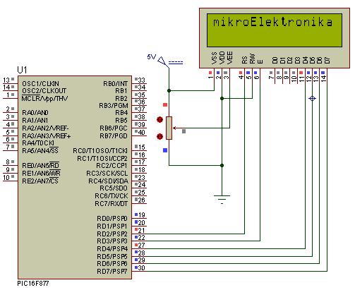

hi all, i m trying to display some text on LCD using pic16f877 but unable to get that.......... only backlight turns on in LCD.
text is displayed on LCD when i m chcking pic on demo board but its not working on my board. circuit diagram i have made ia as follows:
pin 1 of pic to rset button
8 MHz crystal with 22pf cap on 13 n 14 pin
12 n 31 pin ground
11 n 32 pin to +5 V
pin 27 t0 30 connected to pin 11 to 14 pf LCD respectively
pin 21 to pin 4 of LCD
pin 22 to pin 6 of LCD
lcd pins 1,5,7,8,9 n 10 are grounded
pin 2 of LCD connected to +5 V
n pin 3 to variable rheostat of 4k7
m unable to get the prob.
plzzz help
You say that pin #1, /MCLR is connected to the RESET PB, what else do you have connected to pin #1,
is it open circuit if the PB is not operated? [it should go to +5V via a 10K0, with say a 10nF to 0V]
Is it possible to post a listing of your program? Including the _CONFIG statement.
Is your demo board also using a 8MHz xtal, as you are not using the R/W line on the LCD, the program delays may not be long enough.
Its just possible that the crystal osc is not working, can you add a couple of lines to your program,
say set a port pin/high [with a delay interval] to drive a simple R/LED as an indicator that the prog is running?
Maybe this will help?
Note that the PIC's power supply/OSC aren’t shown, your core power/OSC circuit should look a little like this (this is a generic piccy I threw together recently - if you could improve on it then please let me know)

well i hav conncted reset button through pull up resistance of 9.7k n it is at +5v when reset button is not pressed.
n my demo kit is also using 8MHz crystal

ya u r rite i think dere is some prob in crystsl as i m getting a sine wave from crystal instead of a square wave.
If you are measuring the crystal oscillation on one of the crystal wires, using a scope, you will see a sinewave not a square wave.
If you can post your hex code, I will run it thru my PIC test rig, I dont use your version of the Basic compiler.
Do you need to insert an Lcd_Config command? I can't tell from your pin descriptions. Can you post a diagram or a list such as,

my connction are as follows:
LCD - PIC
VSS GND
vdd +5v
vee 4k7 reostat
rs RD2
rw gnd
e RD3
d0 gnd
d1 gnd
d2 gnd
d3 gnd
d4 rd4
d5 RD5
d6 RD6
d7 RD7

The listing you have posted is the 'LST' output from the compiler. In order to
compile and run it I would have to 'strip' out all the hex components.
Also it dosnt show any CONFIG or EQU information.
Do you have just the full assembler listing?

I guess your program works as intended, can you link the mikroBasic source code?

Did you fill in the clock frequency before compiling the code?
It seems like the LCD doesn't initialize properly. You can try to add a small delay, like this:
void main() {
   Delay_ms(20);   // <<<<<
   LCD_Init(&PORTD); // Initialize LCD connected to PORTD
   LCD_Cmd(LCD_CLEAR); // Clear display
   LCD_Cmd(LCD_CURSOR_OFF); // Turn cursor off
   LCD_Out(1,1,"Hello");
