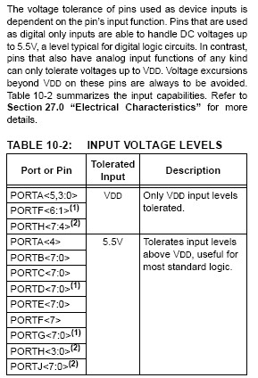

According to the datasheet pins that have no analog inputs can tolerate up to 5.5V
Ah, I see from your other posts that you are using the 18F66J60 which operates from a 3.3V supply and has some 5V tolerant IO pins. If so, then your idea looks like it will work.
