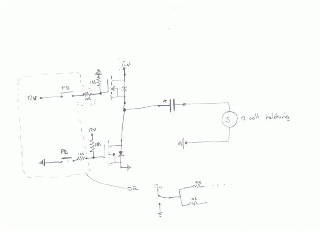

Hello,
I am building a timmer control for an irrigator and need to control a latching solinoid. I am using latching as the system must be powered by batteries (and I am trying to avoid the additional cost of solar).
I have many times created simple switched control of the solinoids that require a short pulse + - to latch and a short pulse - + to delatch using a 2200uf capacitor in series to one of the lines and a SPDT to charge (create latching pulse) and discharge (create delatching pulse). I could simply use a SPDT relay to activate the solinoid but am trying to keep the current consumption down.
The attached pdf shows the SPDT switch that works fine. The other diagrams shows a transistor arrangement I thought would work but does not. The NPN is a BC547 and the PNP is a BC556. I am no electronics expert and really a novice, but this transistor circuit does not appear to be creating enough pulse as the solinoid only makes a dull thud noise and does not latch, even though the capacitor is charged.
Would some sort of N and P Mosfet arrangement work better possibly?
Any suggestions would be much appreciated.
Regards Blair

What is the capacitor supposed to be doing? Are you saying that your circuit "works fine" with that capacitor in place??? Put in some diodes to protect the transistors against inductive kickback from the solEnoid. How much current does your solEnoid draw? What is the battery voltage? Are you biasing the transistors correctly (ie, what are the base resistor values)? What is your control signal? If it is a manual switch, I dont see the point of having the circuit. Are you using a microcontroller and sensors? A better latching switch might comprise an SCR.
Most irrigation solenoids require at least 12 volts, usually closer to 24, especially if there is a lot of water pressure to control. If your system uses full pressure from the water utility and a sprinkler system solenoid valve, make sure your voltage is high enough!!
The switch version draws no steady-state power; the transistor version unfortunately does.
What drives the transistor bases?

What is the Ohmic resistance of the pulsed coil? How many volts is the coil rated for? You are operating the circuit on 12V, right?
The coil is 12 volt rated. I only measure about 5 ohms accross the 2 wires, but not sure how these latching solinoids operates so unsure if that is accross the coil (coils? as think there is actully 3 inside.
I think your problem is when the input signal is neither high or low but floating. In this condition both transistors are on. Maybe you can show us what the actual control switches look like?
Hi Ronv
I have tried to draw what I had working last using Mosfets (I blew it all up and pulled it to pieces before drawing what I had but I think I have the Source and Drains around the correct way - never tried mosfets before - I have a burn on my finger to prove it :-( ).
When it was working (not actually certain why it stopped and got all hot and bothered) I could latch and delatch the solinoid happily by applying 12volts to the 10 ohm resistor on teh N-Channel Mosfet and then delatch by applying Earth to the 10 ohm resistor on the P-Channel.
When I altered as per attached excert to essentially common the gate series resistors to one point and toggle from 12v to G I could not get it to latch or delatch.
Does this make it a little clearer?
Thanks Blair
Sure, that confirms it. Once you tie the gates together the 2 1 meg resistors form a voltage divider and you end up with 6 volts on each gate which probably turns both on. Bet they did get hot. I can only guess that in your actual application you can't have it like your shematic where the gates are separate?

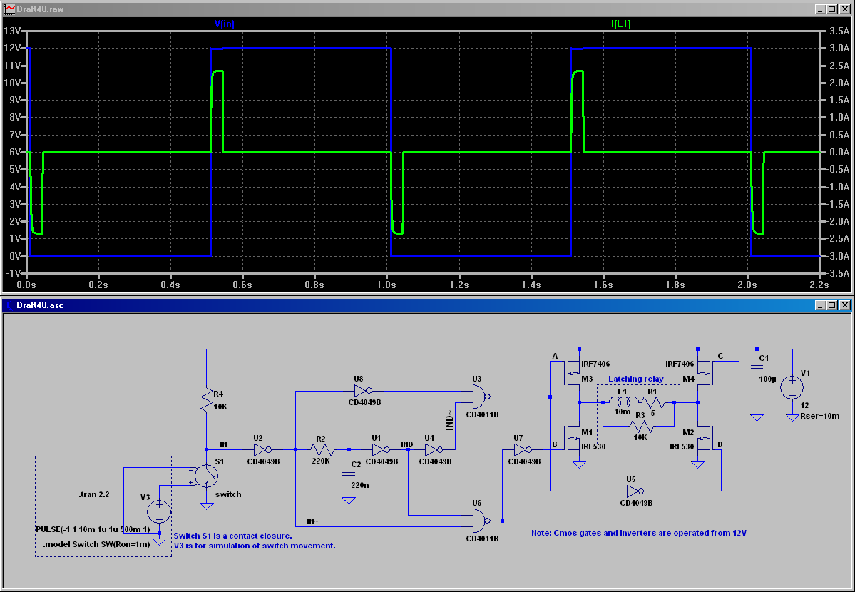

Attached is circuit which will Latch/Unlatch your latching relay based on a simple contact closure, or a logic signal. The power supply drain between pulses is minimal. The peak current through the coil during the pulse is ~2.5A. The pulse duration can be adjusted with R2-C2. The P and N Fets are not critical; they need to be rated for ~25V @ ~3A.

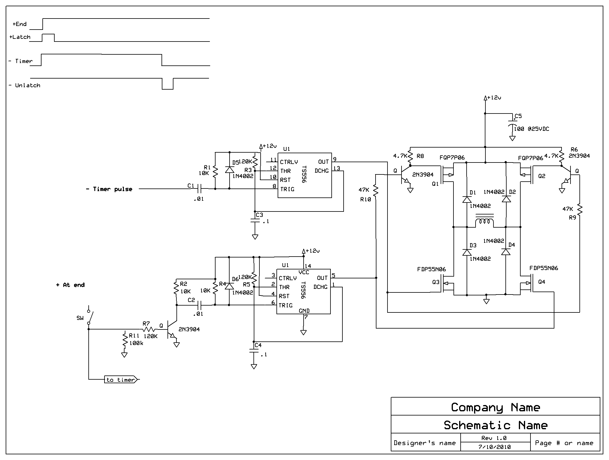

I think I understand what you have. It runs until it gets to the end then you trip a switch (I call it + End). This turns on the small sprinklers for 15 minutes then off with minus timer. (may have to put an inverter in this line to make it compatible with what is now plus timer)
I think something like Mike posted would be better than the capacitor. However that circuit won't work with your inputs. Here is a similar circuit with a little timing diagram to confirm the function. Mike could probably break the single input into two for you if you prefer that circuit. In either case I think the timer glitch has to be fixed. You might drop the reset with the switch instead of applying power with it. The whole thing will probably run with less than .001 amps so if you used a little lead acid battery you could probably get 6 months between charges. (I'm guessing this is what you were going to use since you said 12 volts) Let us know if the timing is correct.

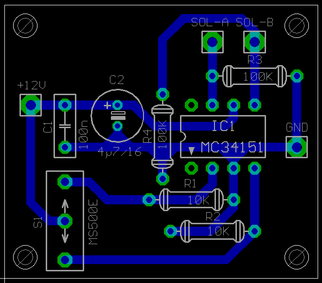

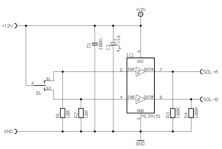

Hi Water_Dr,
here is an easy solution:
Use a dual high speed MosFet driver.
The switch is springloaded in the neutral position.
Toggling it either side will latch/unlatch the solenoid.
Function: Inputs A and B "see" ground via the pull down resistors R1 and R2. This keeps outputs A and B low (ground).
When the switch is thrown towards input A - output A becomes positive while output B remains zero (ground potential). (e.g, latching).
Releasing the switch the solenoid remains latched with no current flow across the coil.
Unlatching works vice versa.
The suggested PCB layout measures 38X33mm.
Regards
Boncuk
...Use a dual high speed MosFet driver....
The MC34151 is only rated to source/sink 0.4A. The OP's solenoid requires 2.5A.
My data sheet says sink or source 1.5A.
It will probably suffice for short pulses, even if the chip is overloaded.
On the other hand - if it's too weak - make it stronger. :)

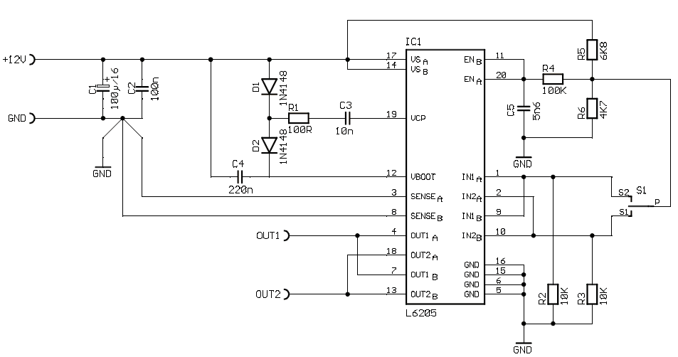

That one can stand 2.8A sustained and 5.6A peak
