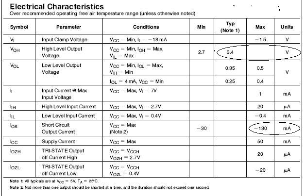

i think somone made a mistake on the data sheet..
i dont see how it is possible to have a positive output voltage of 3.4 V and have the the output current flowing into the device ???
By convention, current out of a pin is negative.
