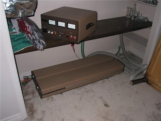

I have 3 watt argon LASER and a 1 watt krypton LASER, the krypton one lights matches no problem. The only catch is that they require a 240V 60A plug and water cooling of the LASER tubes. The laser heads are about 1.5m long and weigh >35 kilograms the power supply has been converted from 3 phase to single phase to run it in my house. Just happy to meet another LASER enthusiast. :)

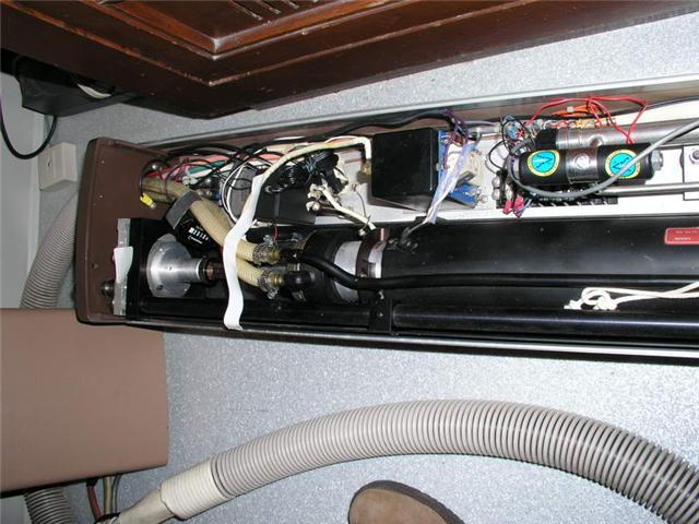

These LASERs work similar to N2 and Co2 LASERs by gas ionization. The tubes have leaked in atmosphere and need to be emptied and filled with clean argon and krypton gas. I have a good vacuum pump that can bring the pressure down to 5 millitorr the tubes need to be filled with clean gas at 120 millitorr for proper operation. I will have that sorted out soon and I will post some pictures and video on the forum.

240V at 60amps? That's 14.4kwwatts of power, for a 1 watt laser? The laser is .00007% effcient? A quick sanity check say something's wrong with the math there, are they really that inefficient?

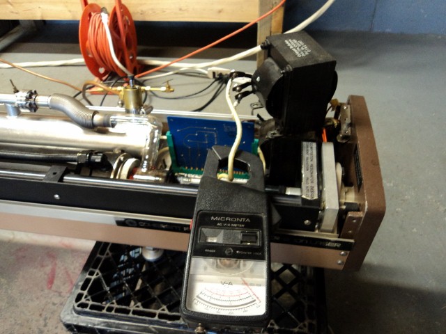

Thats what the guy who gave me the LASERs told me. He has done measurments of the input current and it is 60 amps RMS. I know that it is inefficent, but gas LASERs are pretty inefficent.
The pump that I have is an Edwards 5, 2 stage vacuum pump, it can pull the tube down to 5 millitorr.
There are two tubes, one uses krypton gas and the other uses argon gas.

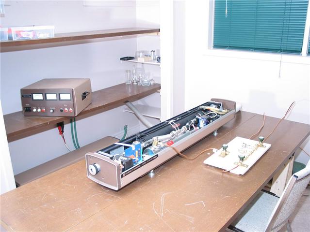

I will clean off the bench and I will take some pictures of the LASER heads and include them in my next post.

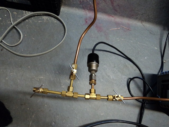

Actually there is no significant leak, the tubes have been sitting idle for >5 years so the vacuum will eventually draw in atmosphere through the smallest of microscopic holes. I am working on the argon tube now, I am connecting the vacuum pump through the gas manifold and pulling a deep vacuum inside the tube.

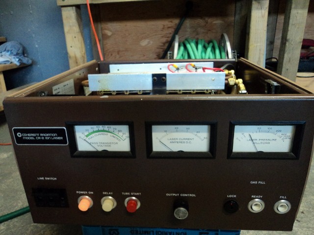

I was connecting the filament to a high current transformer that put out about 3.5V to heat the tube and outgas the filament. I also have some pictures of the LASER power supply and LASER head. I now have the tube sitting at about 10 millitorr (10 microns). I will fill the tubes with gas tomorrow and post some pictures of this beast running.
