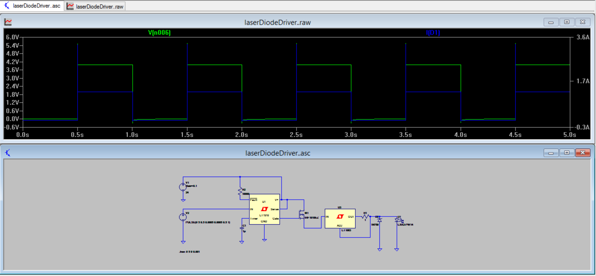

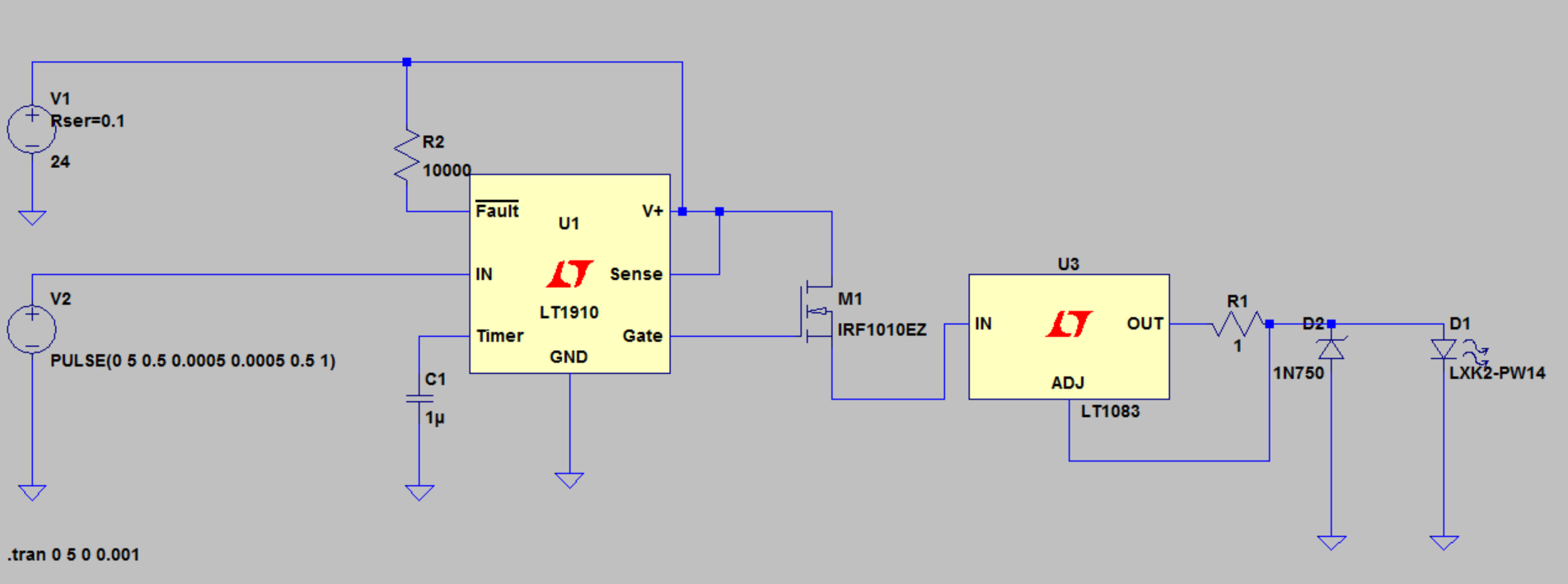

I'm making a laser-diode driver circuit with an enable that accepts 5[V] logic. It's a constant-current supply (from the LT1083 adjustable voltage regulator) to power the laser, a mosfet acting as a switch to turn on the constant current supply, and a mosfet driver IC.
The mosfet is an N-channel mosfet driven with the LT1910 high-side driver.
Right now, I'm simulating a circuit just like this in LTSpice using an LED with comparable voltage-drop and current ratings.
The problem I'm getting is that I'm seeing a voltage spike at the diode's anode, and it's just enough current and voltage to fry the sensitive laser diode. Does anyone know a way to dampen that spike? I've attached an image of the circuit and waveforms below.
Thanks in advance for taking a look!

Try adding a 100uH inductor in series with R1.
