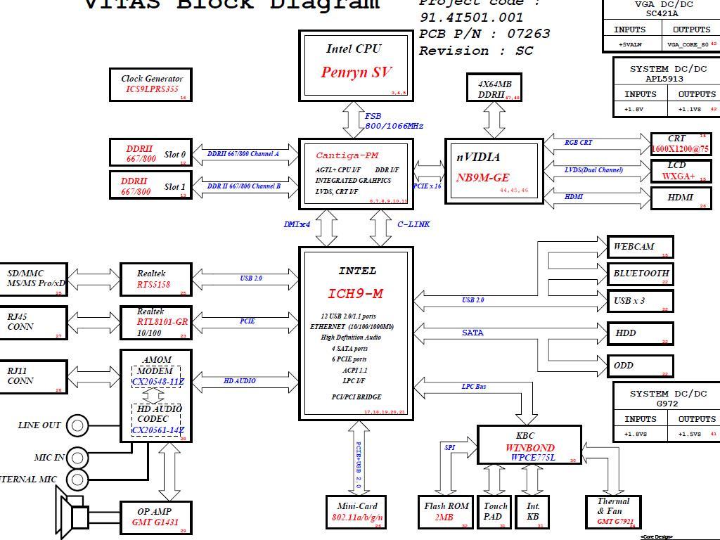

your CQ45 with Nvidia (NB9M-GE)???
here is a block diagram for CQ45 found in net. may be you can get some help here....
Eventually I found a chip mechanics. He says that- main IC of power section might be shorted. He is going to replace to it.

I don't think exactly it's main power ic shorted, main power ic of laptop(in this cq45) is BAT CHEM-- MAX8731 and SMPS IC --TPS51125...
