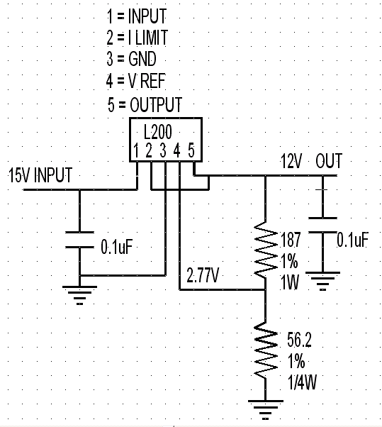

Hi everybody, hope someone can help with this.
I have a old Toshiba laptop power supply that I want to use for a couple of circuits rated at 12v DC 250ma, the markings on the PSU are as follows - input 100v to 240v AC, then under that it says 0.7A - 0.4A.
Then underneath that it says output 15V - 2A, my question is as the supply is already smoothed to DC 15V can I simply take the DC output through a fixed 12V regulator without having to use any other components and is the total load I can actualy draw 2A ?, by the way I am on the UK so will be using 240V.

It will work if you use a low dropout (LDO) regulator and use the recommended input and output capacitors. The max current will be 2 amps or the rating of the regulator, whichever is less.

The L200CV from Maplin will do the job. In the schematic below, the capacitors are the minimum value, you can use larger.
Another example of the impracticability of electronic CAD. The resistors you showed are rather odd values.
If I were to make this then I would simply use a 200 Ohm trimpot and connect the wiper to the Vref pin. Adjust pot until the output voltage is what's required.
