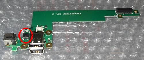

My friend is gonna give me his acer aspire 3680 notebook if I can fix the power on main switch (SW1 which is a small SMD component with 5 leads...Someone busted it by pressing too hard on the switch. It's probably not very difficult to fix if you know the pinout of the switch, but I don't! I don't do SMD stuff yet so I don't know much about these components. So maybe someone around here knows how that little switch works, it has got two pins on one side and three slightly smaller ones on the other, and a flat round black button in the middle.
I guess I could just solder some small wires to the appropriate pins and solder another switch onto those, no? And why are there 5 pins to begin with?
Thank you for taking the time to give me some advice...I think it's an easy repair but I don't want to blow the laptop up!

I'll try to get a picture of that switch up!
Is the switch, circled in red in the attached pic, the one you are referring to?
If so, it's likely to be one of these type of "smd tactile switch":

You will need to take some measurements to get the correct one, such as the footprint and how far the button protrudes etc.

Don't worry, you won't blow the laptop up.
