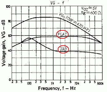

Hi Evgeny,
The application schematics in the datasheets show tape-head preamp/equalizers (NAB), not microphone preamps. A tape head equalizer has a lot of bass-boost that might be causing your "underwater" sound.
Please post which schematic you used (there are a few in the LA3220 datasheet ) and we can tell you which parts to change to make it a mic preamp.

Hi Evgeny,
You don't understand that the LA3220 has NAB tape-head equalization that is not suitable for a mic preamp. You need to modify the circuit for flat response to be a good mic preamp.
I have modified the right channel for flat response for a microphone:
