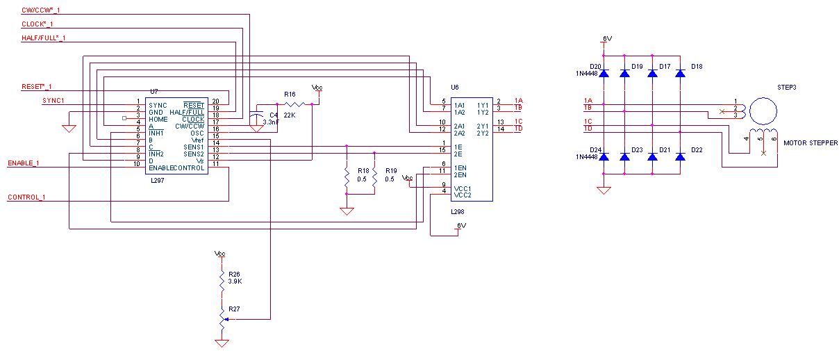

I'm going to connect the circuit to control step motor using both L297, L298 as in the L297 specification.
A few things i widh to ask:
what should the CONTROL pin's value be: 0 or 1?
WHat's the effect of HALF/FULL Step (provided i use the same CLOCK all the time)? is it correct that i does not change the speed but just have a higher resolution of the motor revolution?
It depends on the motor that is connected, the desired speed and the efficiency you're trying to achieve.
Setting it to 0 will send current control thru to INH1 & INH2. This turns OFF all transistors in the H-bridge when the current exceeds the reference level. This will result in current to decay faster and will allow the motor to run faster but hotter. This is used for steppers with high inductance.
Setting it to 1 will send current control thru to ABCD. The freewheeling motor current will decay slower. The current will fluctuate less and so there is less ripple, less core loss and run cooler. Low inductance motors will benefit from this control method.
With the same clock, running at half steps will reduce the RPM to half that of full steps. Half steps will reduce vibration and acoustic noise.
My circuit is as attached. however i found that Motor is very "weak", and slow. WHat factors do you think i can change to improve?
i fix the problem already. I forgot to connect gnd for L298.

hi MrAl,
but, it is already much higher than 6v as it can reach 46V (on the L298 datasheet), another important thing, the voltage depends on the motor caracteristics !!
or didn't I understand you ?

hi MrAl,
Oh ok no problem then, i thought the schematic showed 6v.
Wait a minute...the schem posted by banh *does* show 6v, that's why i commented in the first place.
