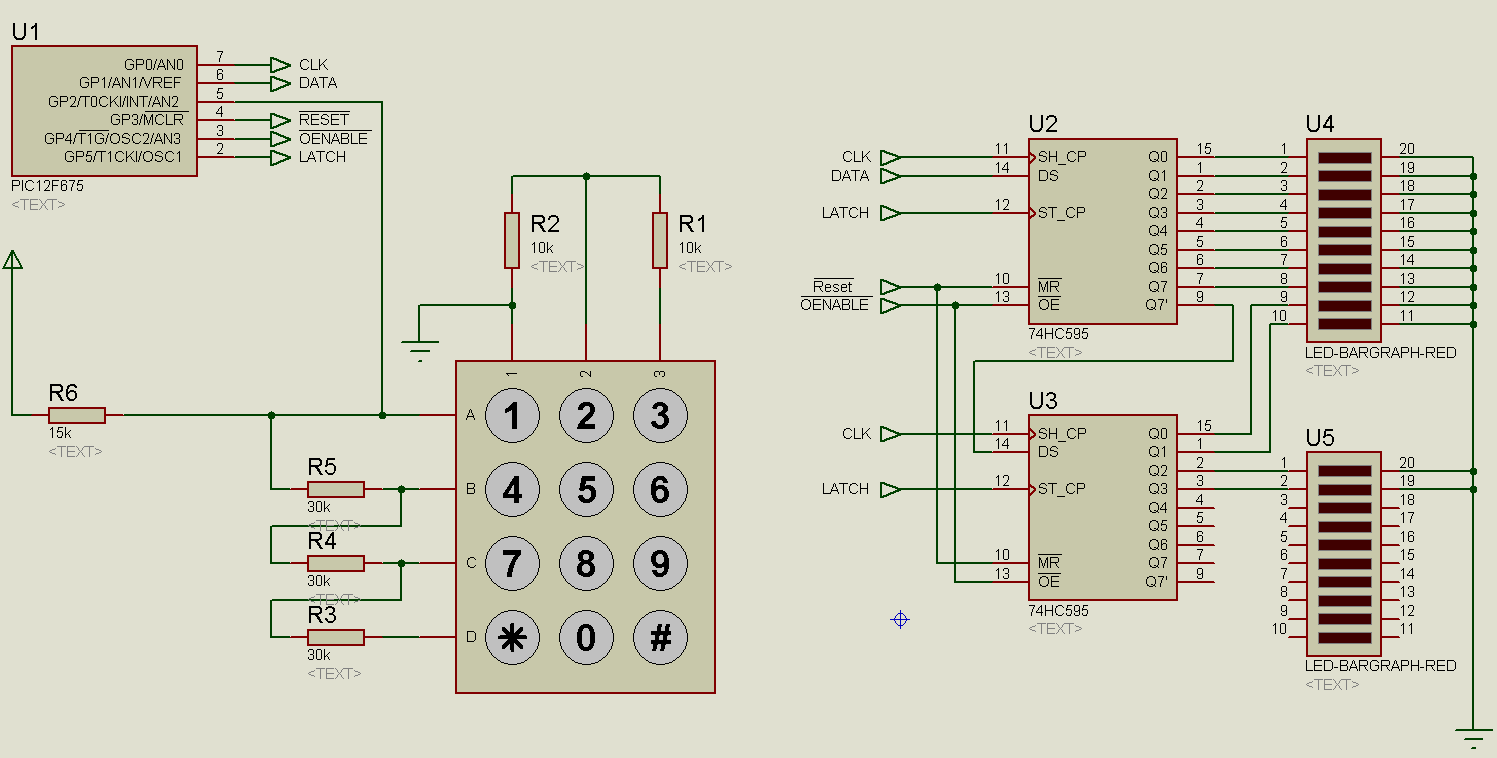

I needed it few hours ago and was unable to find anything "ready to use" so I made it myself.... The principle is fairly simple ... add few resistors to the keypad so you get different resistance for each key, use that resulting keypad as voltage divider (vpp to gnd) and feed the output to ADC of your uC... read the adc, decode the key pressed :)
Attached is schematic (small pic using adc to get the info from keypad and 2 shift's to turn on the "approprate" led). The attached code is in MikroC but it is really simple to write it in any language.

It's a standard technique, and has been used for decades - the second generation VHS VCR's even used it on their cable connected remote control.
It's just a question of working out sensible value resistors - and there's a thread on here somewhere where the calculations were provided.
I personally hate this solution. It is so slow and error prone that it is almost unusable. Just use a bigger chip and read it in the normal way.

the theory is straight forward ... look at the longest path, divide by number of elements in a path and that;s it ... in general for X*Y matrix, on the X side use (X-1) R and on Y side (Y-1) R*(X) .. select R to be some arbitrary value .. (I used 10K) so in this case for R = 10K 3x4 keypad uses 2 10K resistors and 3 30K resistors ... if it was 4x4 keypad for example, with R=10 you would use 3 10K resistors and 3 40K resistors ..
There might be "smarter" way to do it, and 5% tolerance might work .. but this is what first came to my mind :) and as I have bunch of 1% resistors I used them and keypad works perfectly :D (I read correct key every time ... funny results with multiple key;s dough)
