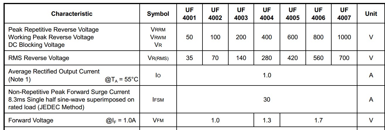

I have never heard this before. I just checked the datasheet and the full range of 1n540# diodes have a forward voltage of 1.2V. Where did you hear this?
Have a look at the datasheet for uf400X, for an extreme case.
Poms, its the reverse voltage they were talking about, that is how much voltage the diode can withstand when its off.
Forward voltage (0.6v) is not often considered except for high power applications such as switching supplies where schottky diodes are often used which have a forward voltage of 0.4v or thereabouts.

You need to reread the above posts.
Use the 5408 Diode.
Having a HIGHER Rated Voltage Diode is Always Preferred To one that is Under Rated in Voltage or Amperage.
Doing a Test on a 1N5400, 1N5406 and a 1N5408, ALL Three Basically Measured the Same Forward Voltage Drop. Give or Take 0.1 Volt.
