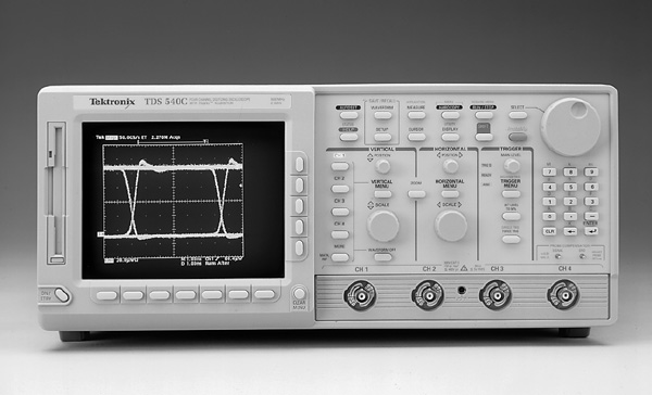

So I went down to the junk room again to pick up my scopes and take them to the salvage building.
I was looking around some more and I found this guy on one of the back shelves.
The screen was pointed towards the wall which is why I didnt notice it before. The tag says uncalibrated, unrepairable, and "R+C Probe Comp Bad" what does this mean? the scope comes on just fine and all of the self tests pass.
:shock: WHOA! a quick ebay search shows this scope selling for +$3,000.00 ....yeah umm... for that price, I may just take it :twisted: .

I asked about the TDS 540, and they are keeping it for parts :cry:
