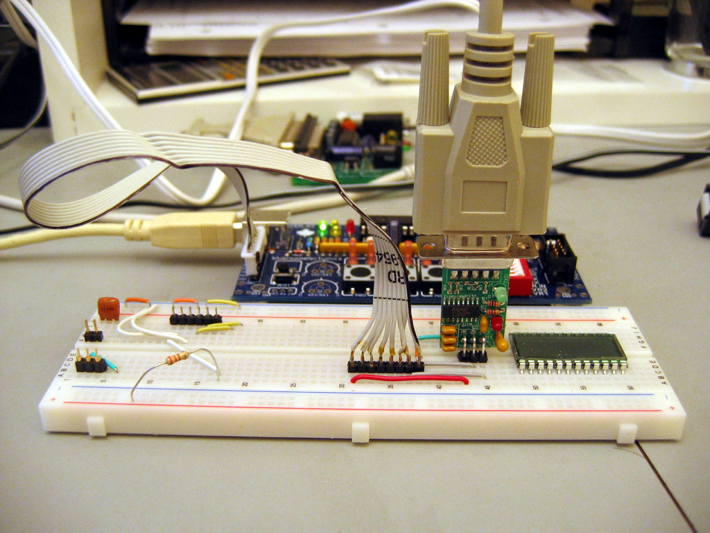

Technological Arts always used to pre-program their Motorola boards with simple little test programs. That way, when you unpacked it and hooked it up it would be able to do something right away.
So I started writing one for the Junebug 18F1320. It's simple polled RS232 at present and doesn't test absolutely everything on the board yet, as I don't have some components installed yet. I expect to have my trimpots this week, and I think I have one of those IR sensors somewhere in a junkbox. When those parts are installed I'll finish the program, as well as make it more interrupt-driven (not that it really matters in this program, but it's a nicer way to do it).
Here's a pic of the RS232 hookup. That's a Techno Arts RS232 ComStamp doing the level shifting on the breadboard. Of course any level shifter will do. **broken link removed**. Sparkfun Electronics. Acroname.
The display to the right on the breadboard and all the parts to the left are not connected at present. They're just leftovers from a previous project.

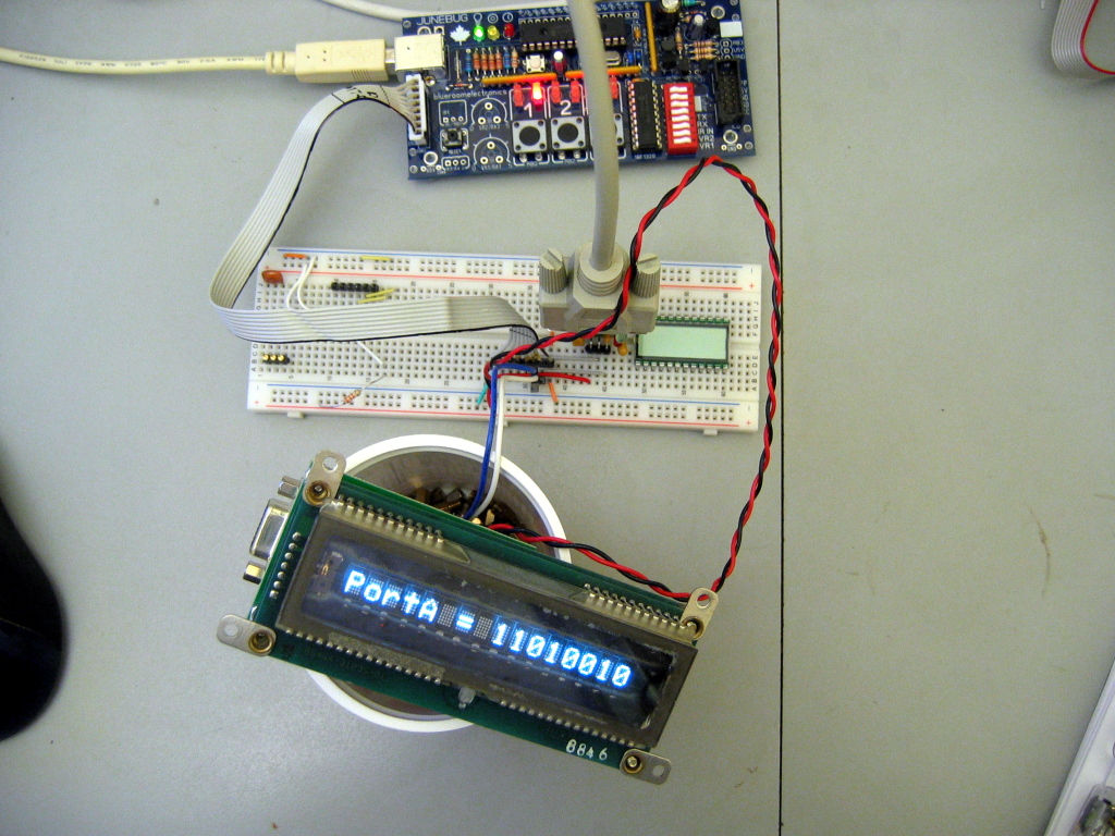

Here it is with code slightly modified for display on a **broken link removed**
Oh ya! It runs at 9600 baud, 8N1 for now, so set up your terminal accordingly.
