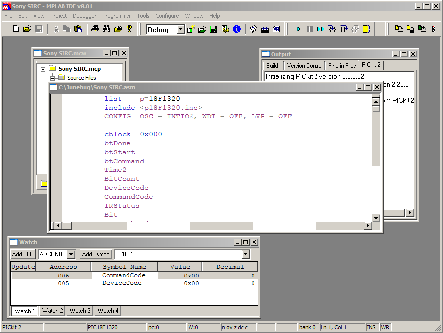

Now to learn how to run the debugger.
Programmed and how to test JUnebuy sirc ir.asm properly
I ran the program on the Junebug, got the LED1 and LED2 to illuminate when I fired a SIRC signal at it.
Am I correct in assuming iaw a debugger that I select debugger>select tool>MPLAB SIM
How do I read the contents of DEVICECODE & COMMANDCODE?
On reset LED1 lights and on a valid code LED2 will light. Open a View/Watch window and add symbols CommandCode and DeviceCode.
Vaild 12bit codes will show there.
An enhancement to the program would be to send the codes out the EUSART and you could view them with the UART tool.
