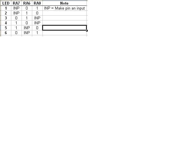

EDIT: Oh ya, here's a truth table I made. You may find it helpful for getting the Junebug LEDs to do what you want.
It's commonly called Charlieplexing. Microchip has an app note on it and it's also seen in the PICkit 1.

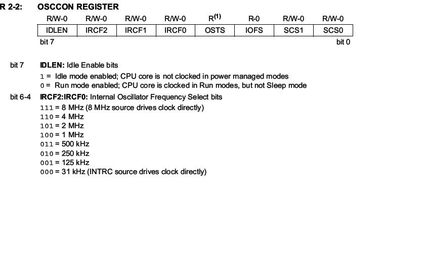

I believe the default internal clock speed is 31.25KHz. That's why I bumped it up in my code to 8MHz. 31.25KHz is too slow to do the interrupt thing.
Here's the controls for that:
As you can see, the internal clock can be set for a range of speeds from 31KHz up to 8MHz.

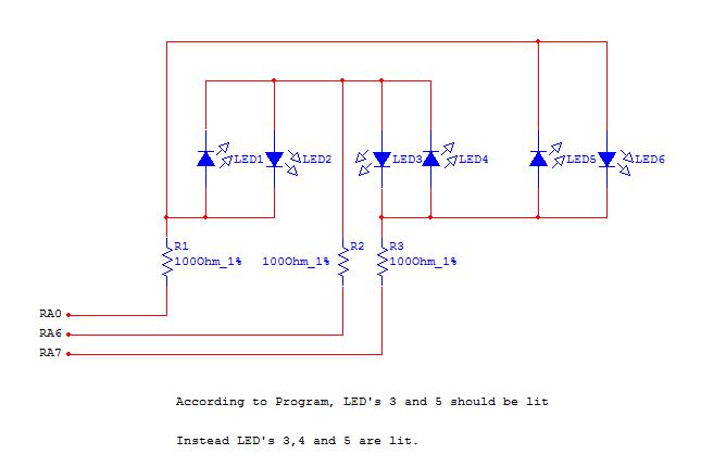

For the sake of the thread I shall fill in some of the blanks for people who have no idea what the issue was and try to tell you what caused it ('cos I think I worked it out).
The JuneBug has a great pin saving feature allowing you to light any of 6 LEDS via 3 pins. (It's a technique Bill called "CharliePlexing").
I wanted to get LED's 3 and 5 lit simultaneously (or at least appear that way), the code I hope would do it is below. A snippet of the circuit is attached as well.
LED		macro	x,y                        ; MACRO LED <PORTA>, <TRISA>
		movlw	x
		movwf	LATA                       ; LATA  = x
		movlw	y
		movwf	TRISA                      ; TRISA = y
		endm                                ; end macro
		org		0                          ; reset vector
		bsf		ADCON1, 0                  ; make RA0 digital
		bsf		TRISB, 0
START
LED3	LED		b'01000000', b'00111111'
LED5	LED		b'10000000', b'01111110'
		goto	START
Instead what happened is that LED's 3,4 and five would light up, although LED 4 would be only slightly dimmer.
The reason? to find the answer lets assume that LED 3 is Lit and LED 5 is "about" to be lit.
As the MACRO indicates the first thing that happens is that LATA changes from b'01000000' to b'10000000', this means effectively that the path of current changes, from originally flowing through LED3 to flowing back to RA6 through LED4 (making it light) before getting to the TRISA b'01111110' which changes the outputs.
This is only brief, but enough to make LED 4 light.
Futz and Bill have made suggestions to solve the problem by introducing accurate timing by interrupts (though I am yet to grasp that bit).
I hope this makes sense, if anyone has any comments please feel free.
Oh, that explains it! :D I hadn't figured that out, but my suggestion to "just go faster" was a fine cure. Now that you know this, you can fix it and still go slow?
