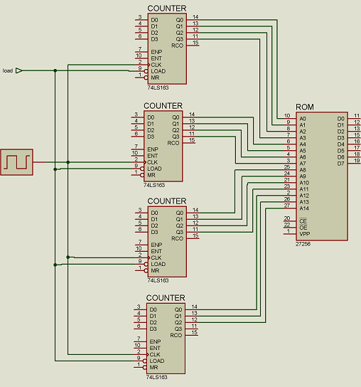

suppose I have 15 address line and 4 data line
what Extra circuit I have to Add with that circuit to execute jump and branch instruction ?
Usually the program counter already has an adder inside it so that it can increment, so your relative jump would modify that to enable it to jump a few adresses from the current address. For a long jump you simply load new address into PC.
Branch instruction needs something to decide whether it should branch or continue to next instruction, this is usually based on some bit in status register, the simplest being zero flag which is zero when the result of the last operation was zero.
ok I have to make loadable Pc that will load or increment. I have to select its branch instruction , jump instruction , its call instruction or subroutine instruction, can I use 4 input multiplexer to select jump, branch, subroutine , next instruction?

anyway e I want to make block diagram that will do following function
1)loadable program counter
(address +1 ) or (new address )
2) Jump If Accumulator is zero if not then execute next instruction
3) jump If accumulator is not zero if not then execute next instruction
4) jump if register R is zero if not then execute next instruction
5)jump if register R is not zero if not then execute next instruction
I am not sure this example is enough for learning. I just want to make small one I don't understand where to start ? what I need ?
I am just taking different example for basic understanding. I just want to make block diagram
I don't understand 8051 architecture . its more complicated for me
can you please tell me how to make loadable program counter ?
