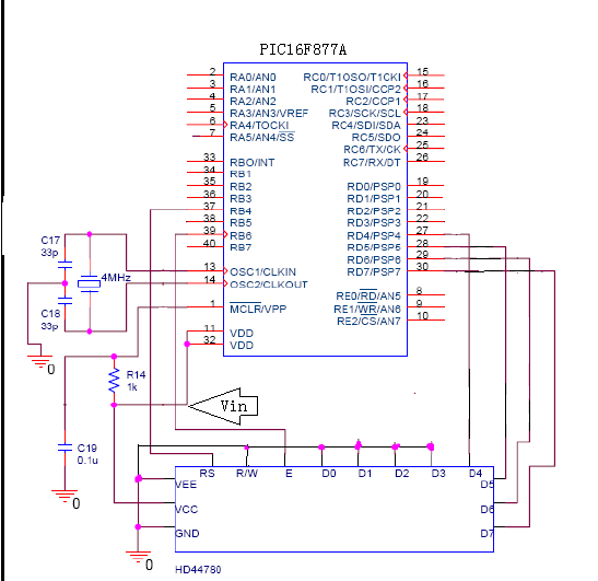

i written a program to display using JHD 162A LCD.
i using MikroC Compiler and i quite sure that my program do nt have any error.
but after i download the program into PIC and run it, it shows black box at the 1st row of my LCD. it remain unchanged even i remove my PIC.
this is my circuit and the code i write, is there any problem or any configuration need to be done that i have left?

i have replaced the MCLR resistor with 8.2k and add a 100ms delay before i call lcdinit, but it doesn't work also.
the black box still appear there.

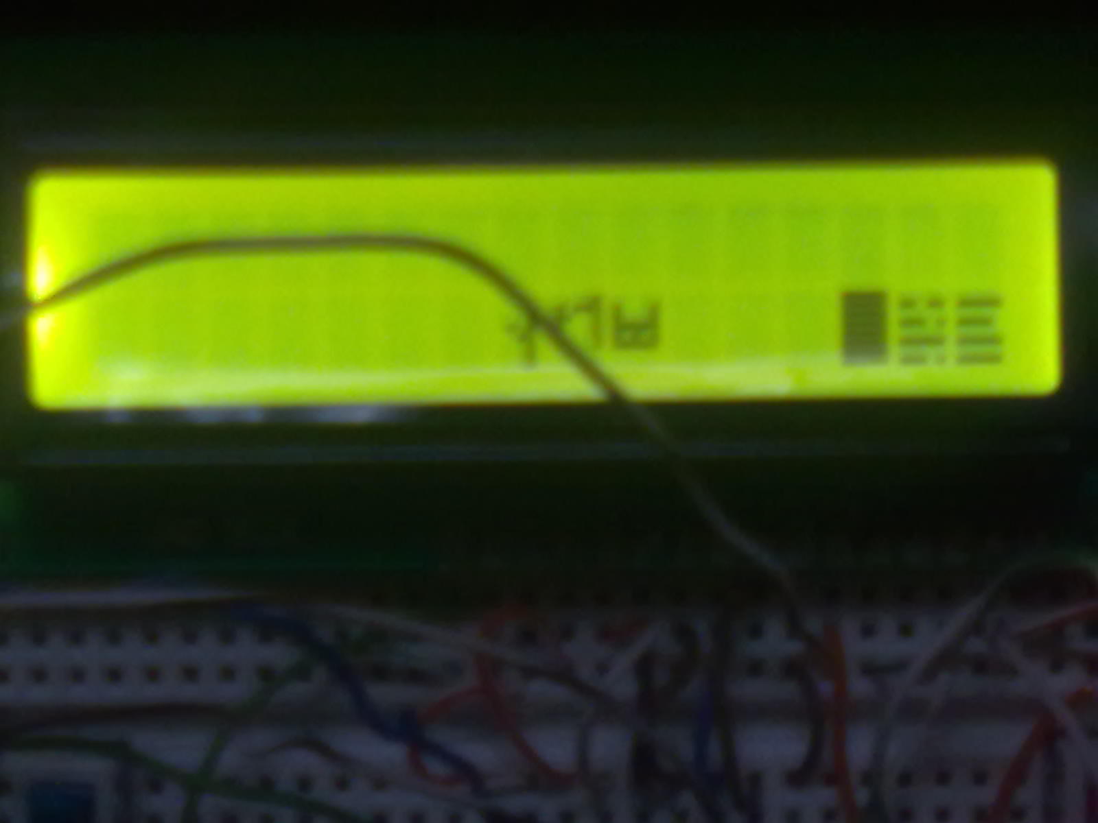

When you say black box.. Do you mean the whole top line of the display, or just one at the beginning of the first line?
If the whole of the top line is bars!! the screen isn't initialized.
Is this project built on breadboard... If so ditch the xtal caps

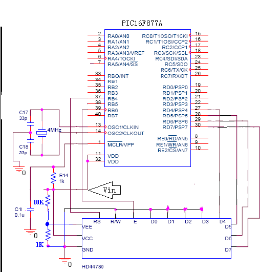

there is a mistake in handling the Vee pin of the display. it is for contrast
generally this pin should have a voltage around 0.7 to 1V wrt gnd. People use a 10K preset across supply connecting the variable pin to Vee pin. It is adjusted to get best contrast. otherwise one can comfortably use 2 resistors as shown below.

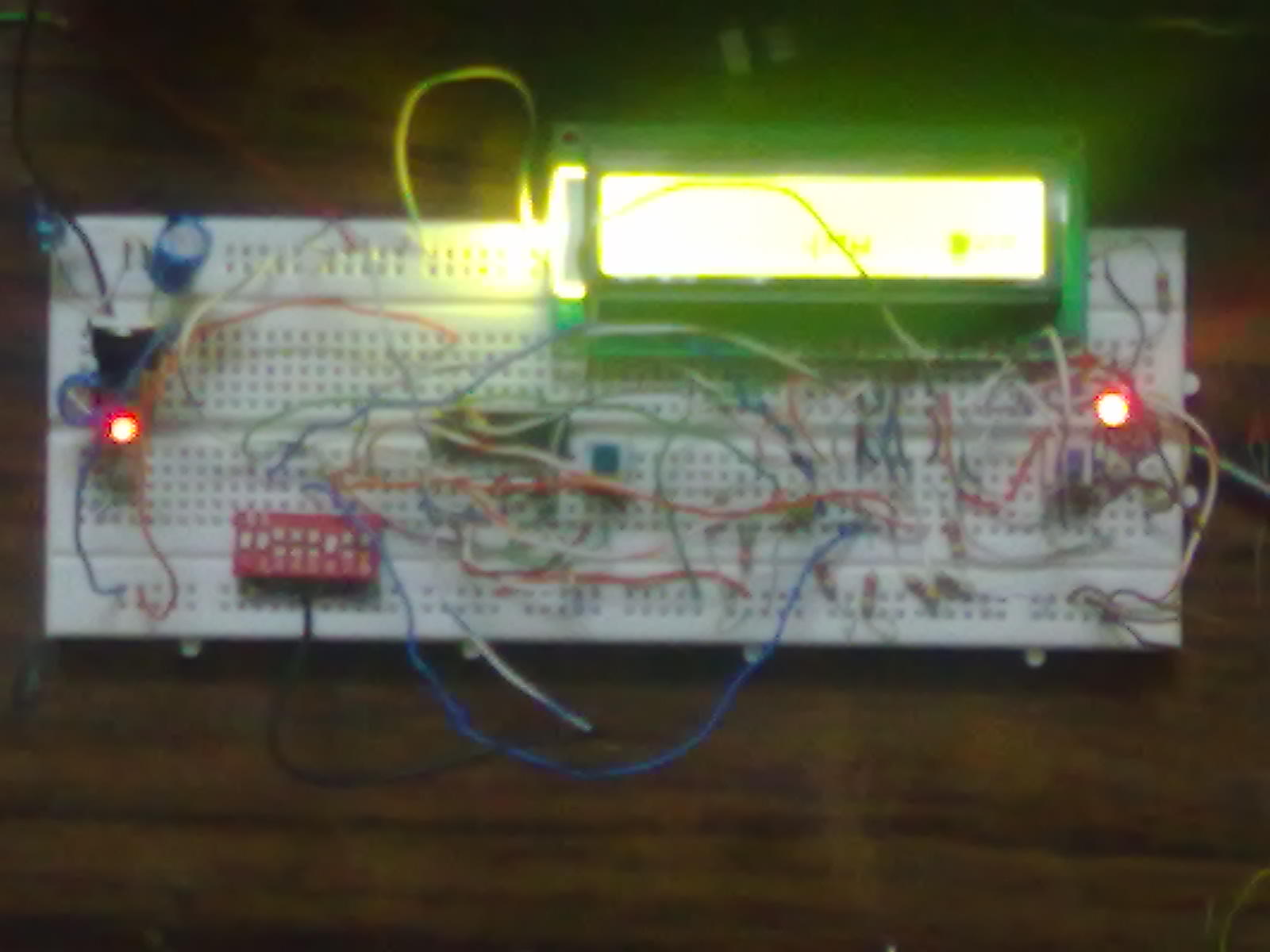

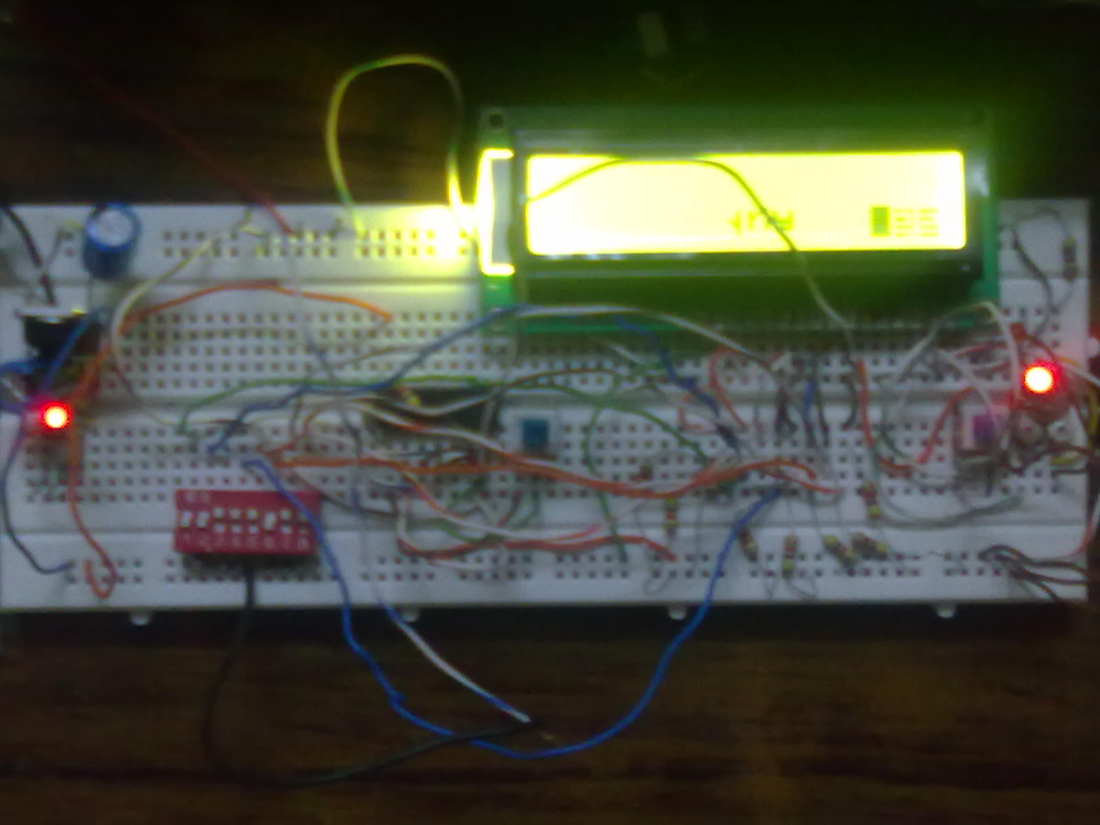

In past i was using this 16X2 LCD with denounce switch and DIP for addressing data....
