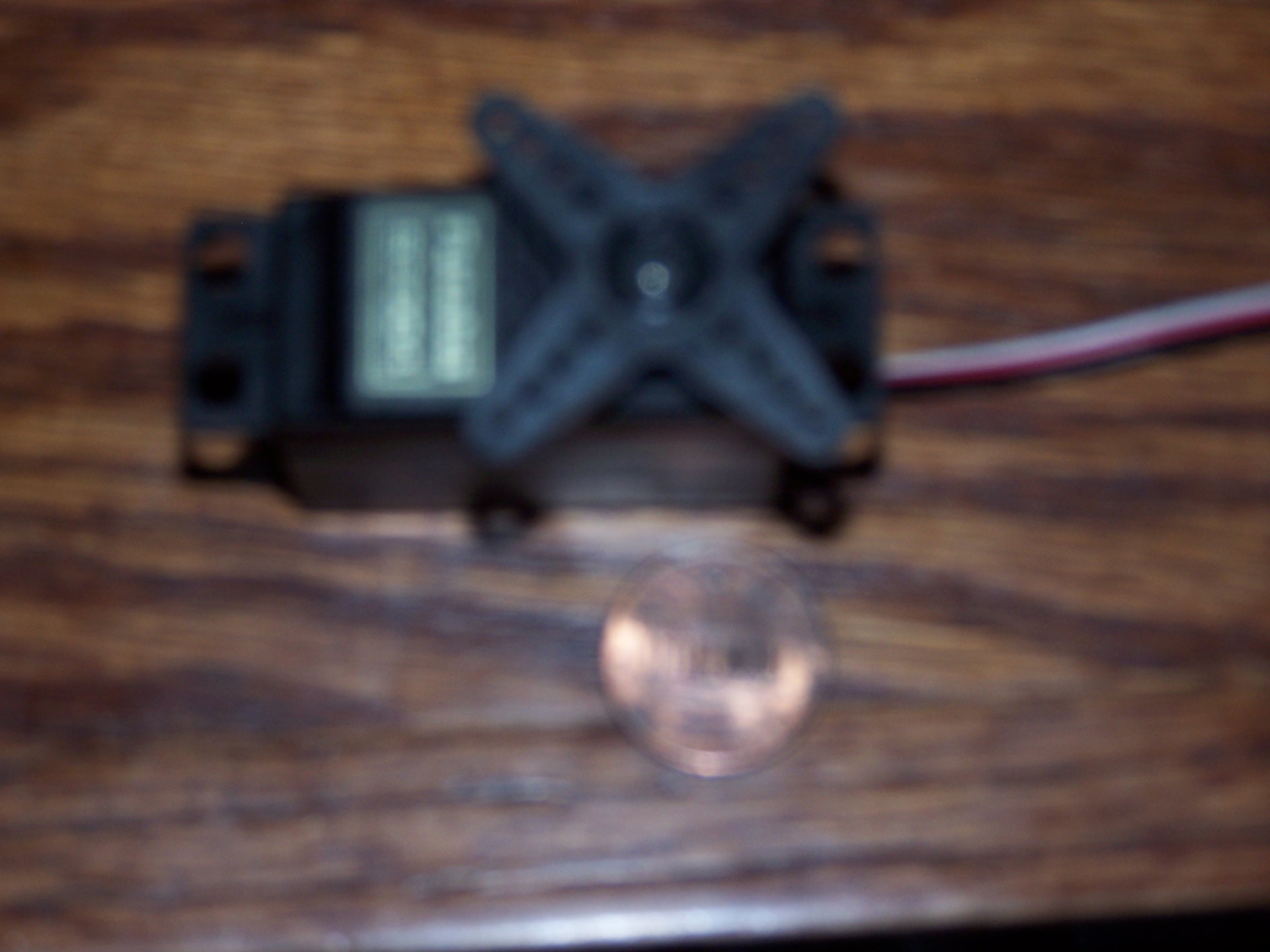

A servo motor would give you smooth turns, but probably better suited to a microcontroller based robot. I did build a servo tester with a single 555 timer, so it's not impossable to use one from an R/C model. Most any other gearhead or stepping motor would require some kind of position feedback or limit switches.

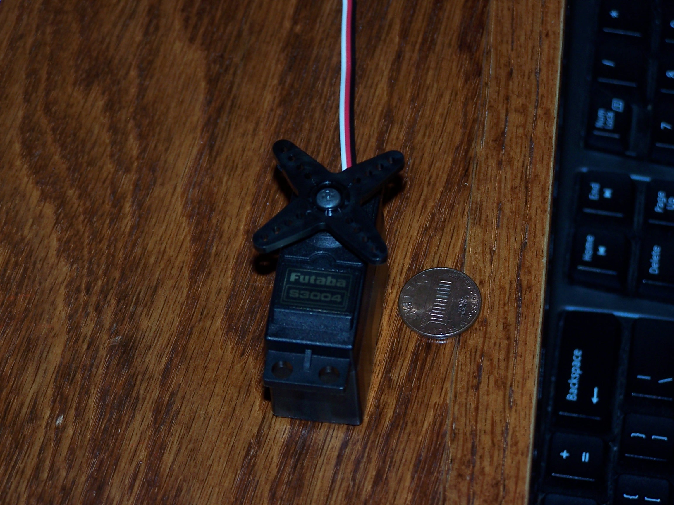

Jeeperz is going to be a room exploring robot, meaning it is going to go straight at all times, while the steering will move it closer and farther from the wall. It will use 4 pairs of IR emitter/receivers, which will interact with steering, BUT NOT THE REAR WHEEL! (drives like a rear wheel drive car). THE rear wheels will be constantly on. I was going to use a H-bridge for steering, and works exactly what hank said. It pegs out and turns either all the way left or all the way right. It has a spring that centers it when it goes straight. I bought a standard servo (Futaba S3004) and I am going to try and use that for steering. Here are some pictures.
Any mounting Ideas for steering?

I have some Jeeperz Pictures!!!

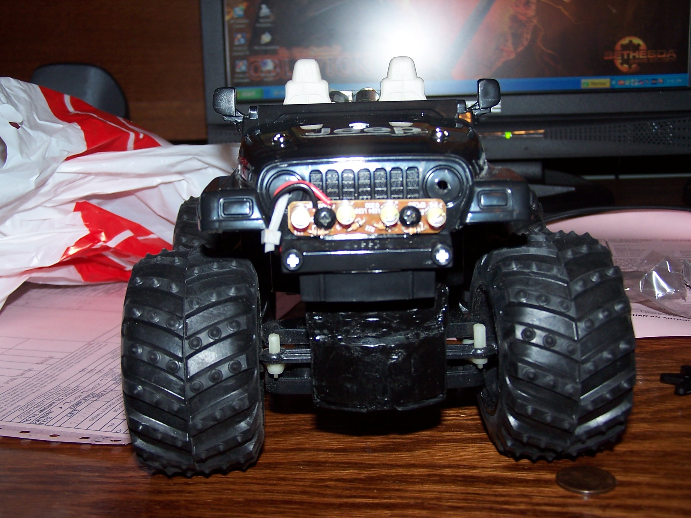

343: Frontal View: Note the "headlights" (4 white LED's) that I installed with wood screws. removed from old "gameboy" LCD backlight. Also if you look closely, you can see the 2 standoff screws on the Hood of Jeeperz, also the Jeep sticker.

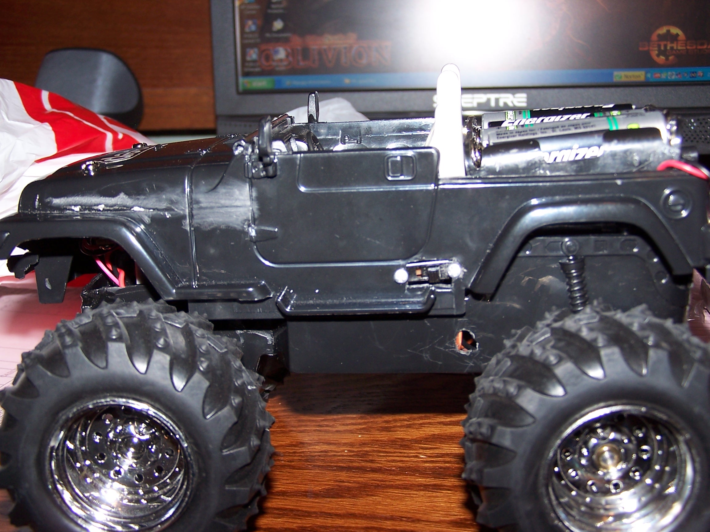

344: Side view showing the power switch, Battery pack (in jeeperz' Trunk space) and frontal cut out for board (the perf board was too big, so I removed some stuff with rotary drill).

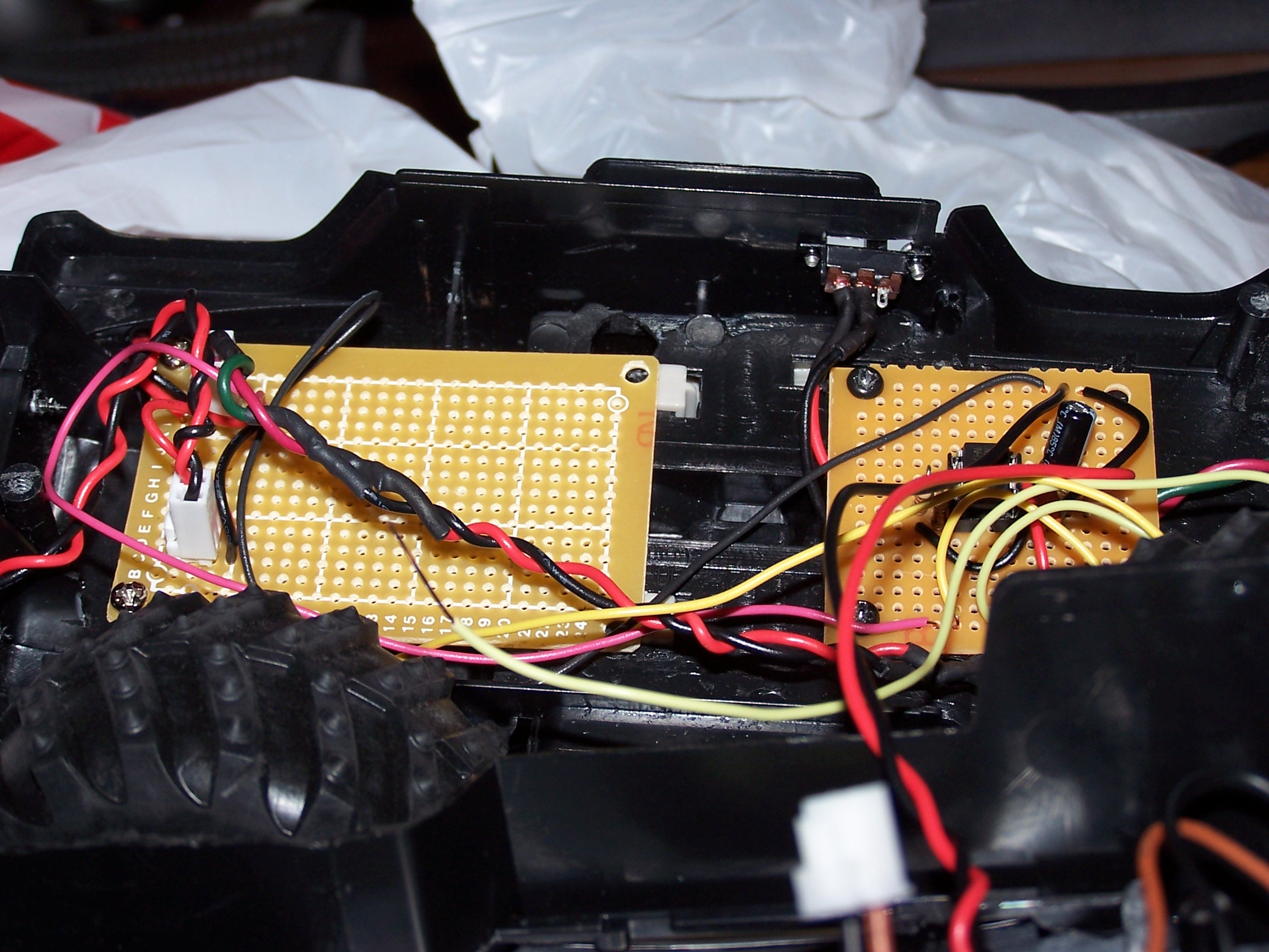

345: Room seeking board on left (incomplete) and the impact sensor on the right. When Jeeperz hits a wall, it activates a 555 timer to emit a pircing tone, to protect from stalling motor. Underneath the Roomseeking board is a massive cap (3300uf) for when both motors kick in, it helps supply the rest of the bot. The seat screws (to mount the seats in) was spaced perfectly for the impact sensor board. The room seeking board required standoffs.

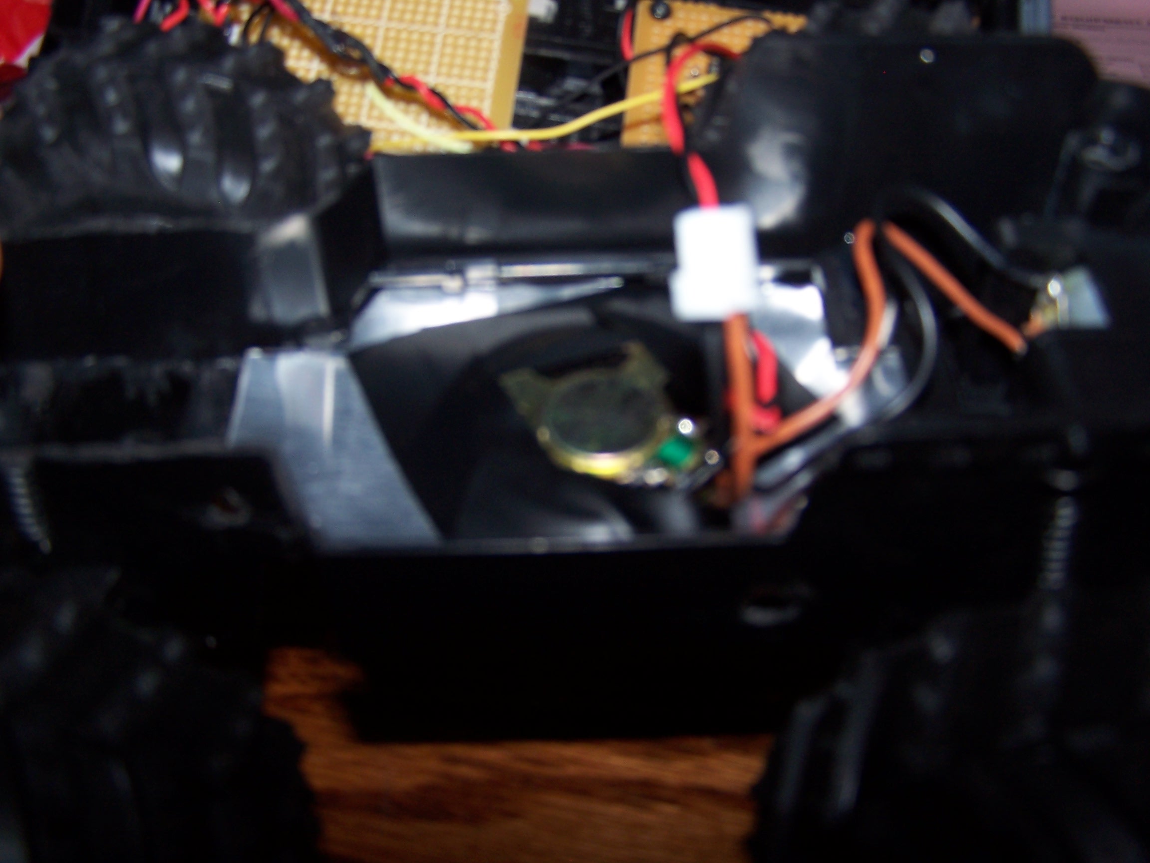

347: Speaker for impact sensor mounted to metal plate for added resonance (totally just made that up)

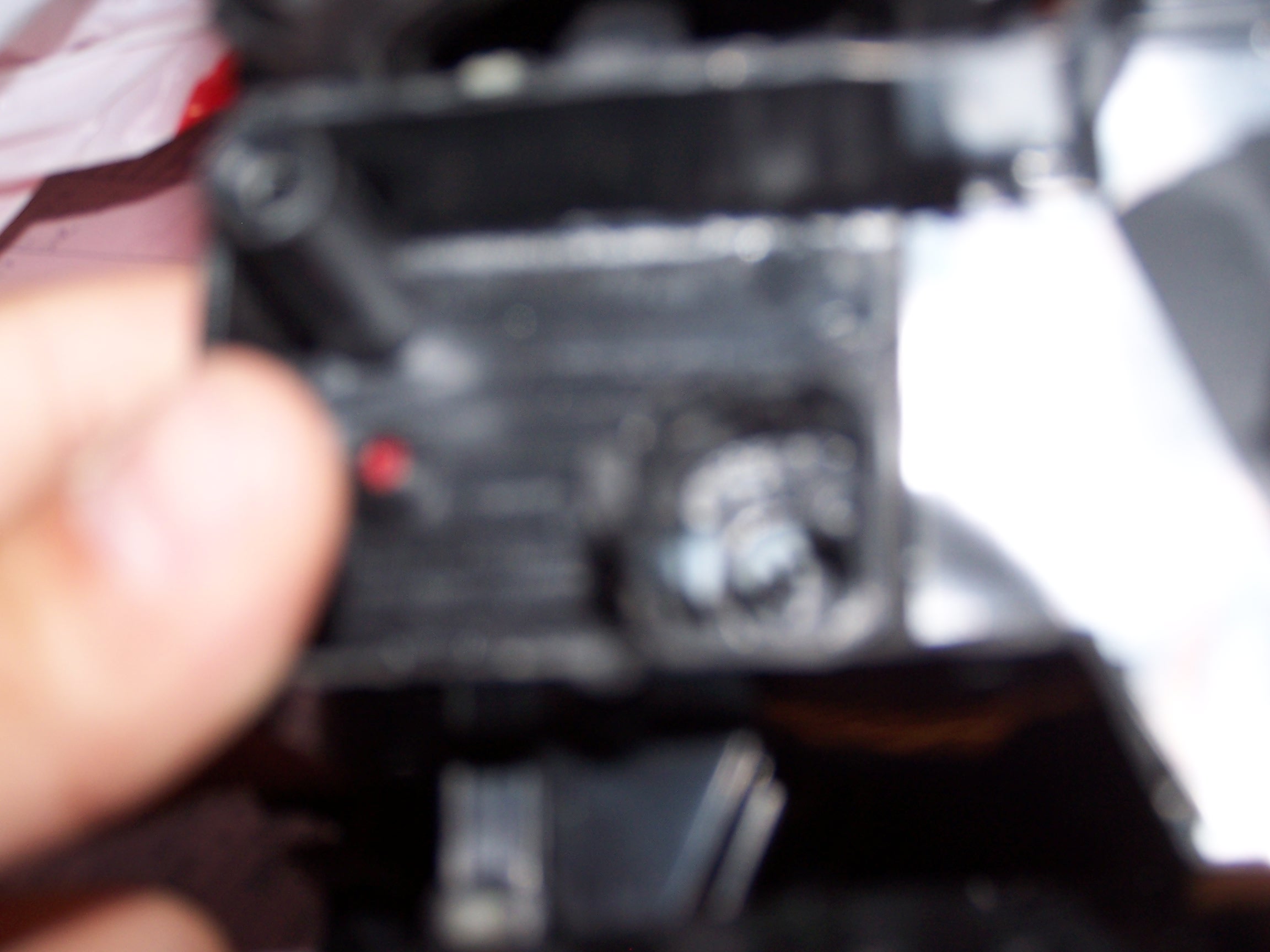

348: Supposed to be the front motor mounting, for turning
