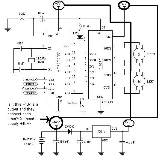

Hi I want to make a line follower robot.But I have a problem to write
the program into the microcontroller AT89C2051.I need a JDM programmer.Do u hav any JDM programmer that is easy to build on my own?Please give me the schematic as well as the components details.
I refer to this line follower robot website.
ThanX.
Sorry about this so ashamed question.I actually can't understand this circuit.I'm a newbie dude!
Hiya Arezamy,
The 10 volts you circled near the battery is actually the battery voltage which feeds into a 5 volt regulator to give you 5 volts for the processor and the 10 volt rail is the supply for the motors. The L293 has been replaced by the sn755410ne chip from TI which can handle 1 amp of motor current as the L293 can only handle 500 milliamps. If you read up on the datasheet it tells you everything you need to know.

A JDM programmer will not work in your case. You need to use a parallel-type programmer in order to program the At89C2051, which needs 8-bit of data all at once to program a single byte.
The schematics of a suitable programmer is here:
Schematic of TAFE Programmer
You can use the ICProg software to sent the hex file to the 89c2051.
