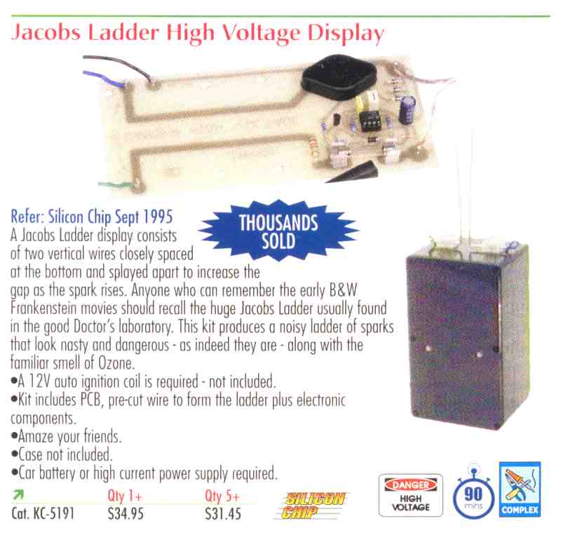

Eh Zach,
heres a photo of a kit you can get for a jacobs ladder. The project was in Sept 1995 in siliconchip but I dont have any issues that far back or I'd scan the article for you. But as you can see all you need is a automotive coil a few components and a car battery for power. Alternatively you could email siliconchip and pay $8.80 Oz for the project but hopefully someone has an old copy of the mag and can scan it for you.
Cheers Bryan1 :D

Bryan, that jacob's ladder looks kind of small :lol: . I want a mains operated ladder so that it's bigger :twisted:
