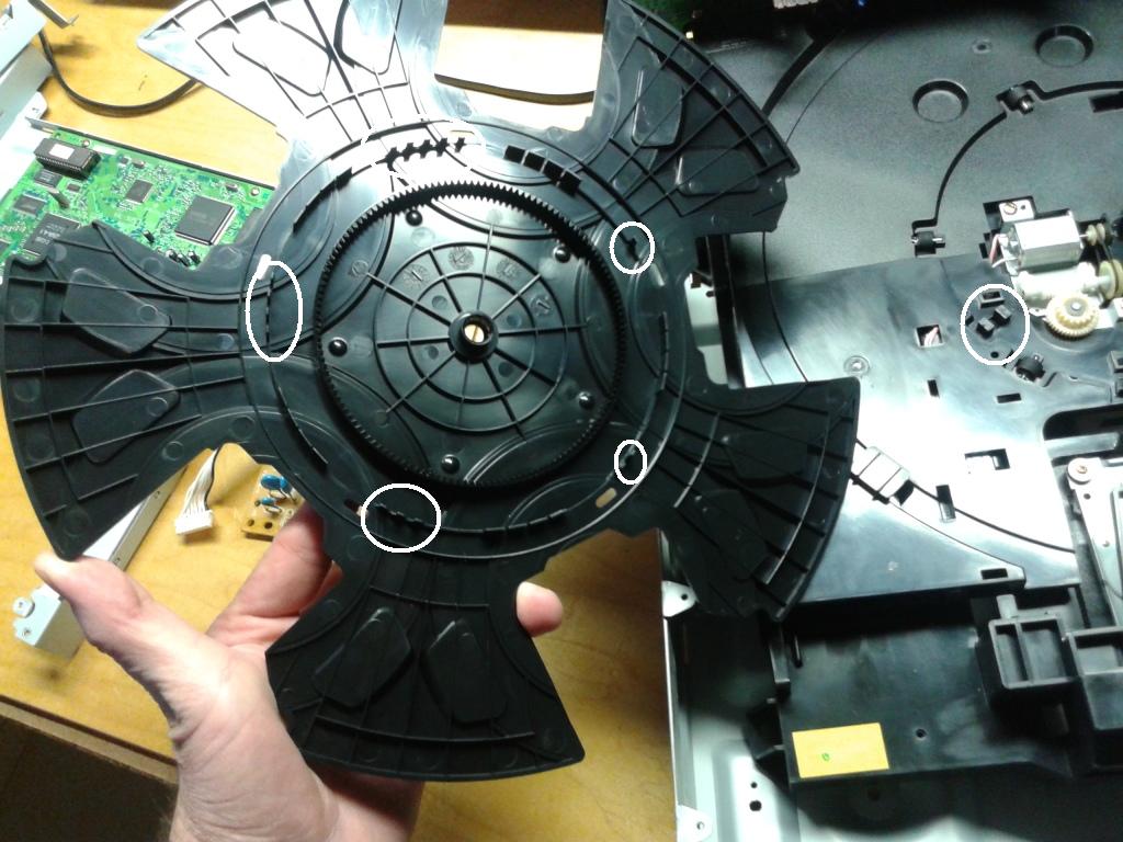

(This is in regards to a 5 disk RCA model RC5910P-D)
The other day while I was picking a new DVD to play, I stood up and hit my head on the open carousel drawer. After that it only shut part way and I tried to help it with a little force :nailbiting: (go ahead and cringe now). I managed to get it shut ....but then it needed a little help getting open and...it kind of slid freely after that. :banghead: Well thinking it was just plain broke I tried seeing if the carousel would move, it did a little. :facepalm: Realizing I was only making things worse I walked away from the device. So later, when I calmed down and evolved I took the cover off and found a DVD lodged in the back (from my head butt) that was easily removed. All would have been well if I had done that first, so lesson learned.
Well when I put it back together the drawer didn't respond and just kept flashing "Goodbye, goodbye". So I disassembled it and found that there was a ribbon cable from the tray to a board unplugged and I plugged it back in. Now the drawer does respond and the carousel rotates, but it seems as though it is not "synced?" with the player. It just keeps cycling through the disks...Is there some way to align the tray the way it's supposed to be, so that it corresponds with the numbering (disk 1, disk 2 etc..)? Or is it just in need of a "back to factory" type of setting thing?
Any help would be greatly appreciated. I've seen one of these and comparable sony ones on ebay for $50-70 but if there is something I can do to get this one back up and running that would be better. It's just for my workshop, not the house dvd player.

The only method for the machine to know where the carousel is (and if it has any discs) that I can see from your photos, is the 'infra-red pair' (by the edge of the large rectangular cutout). That could be worth investigating.

Electro-derp, I've just noticed a 'slotted opto-isolator', just south of the carousel turning gear (last picture). That would give an indication of carousel position, but not necessarily which one. No doubt attached to the ribbon cable. Speaking of which, examine the end of that cable for bent connections.

Hi Electro-derp
I had a similar problem with a multidisc CD player which I did eventually solved although I can't remember much now, it was a while ago.
However, I've attached a copy of one of your pics showing the underside of the carousel and I've circled 5 points on the picture. These coincide with the disc slots and pass through the opto isolator also circled on the pic just below the drive unit.. If you look between these points there is a common. what looks like 4 square plates between each one which I think needs to be in the opto isolator when the disc is in play position. It may be a case of trial and error to find the location exactly but it should be possible.
Hope this helps

Yes it reads those slots under the carousel and then stops. I think its out of sync and lost.
Clean the sensor and try putting it back in in different positions and see if you can get it to work.
Thanks Musicmanager & 4pyros, I'll try that. I knew there was some significance to those slots but didn't look at it long enough. Clearly they are numbered.
You mention that 'a motor keeps whirring while it's open'. This could be important. Try cleaning the drive belts and pulleys with some kind of alcohol, nail polish remover etc, particularly the one in the lower right side of the last picture in post #2.
I think what is happening here is that a mechanism isn't quite reaching it's limit switch. If I'm not mistaken, the one in post #2 is the one that seperates the magnetic halves of the player itself. In CD drives it is a common cause of misery.
