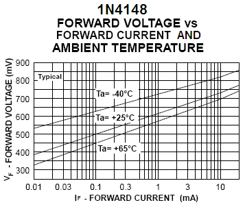

How do i view the from IV characteristics curve to determine for (1) silicon pn junction diode, rectifying diode,voltage regulating diode, light emitting diode?
The datasheets have typical curves of the IV of all the diodes and also show the effect of temperature change.
You can measure the IV yourself by feeding the current and measuring the voltage.
