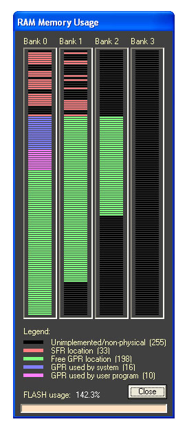

Out of memory?
Aha! - The OSHON compiler reports the flash usgae at 142.3%
Does this mean I am out of memory?

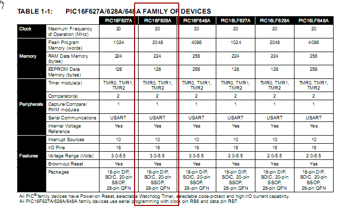

Hmmm apparently thats it. Chop a few new subroutines out and all is well. So why does the Image above show loads of space on the PIC or am I reading it wrong?

Consider the different types of memory,,, Flash program and RAM registers [memory]
