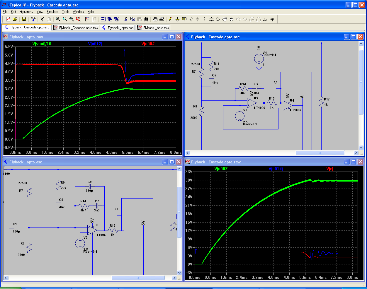

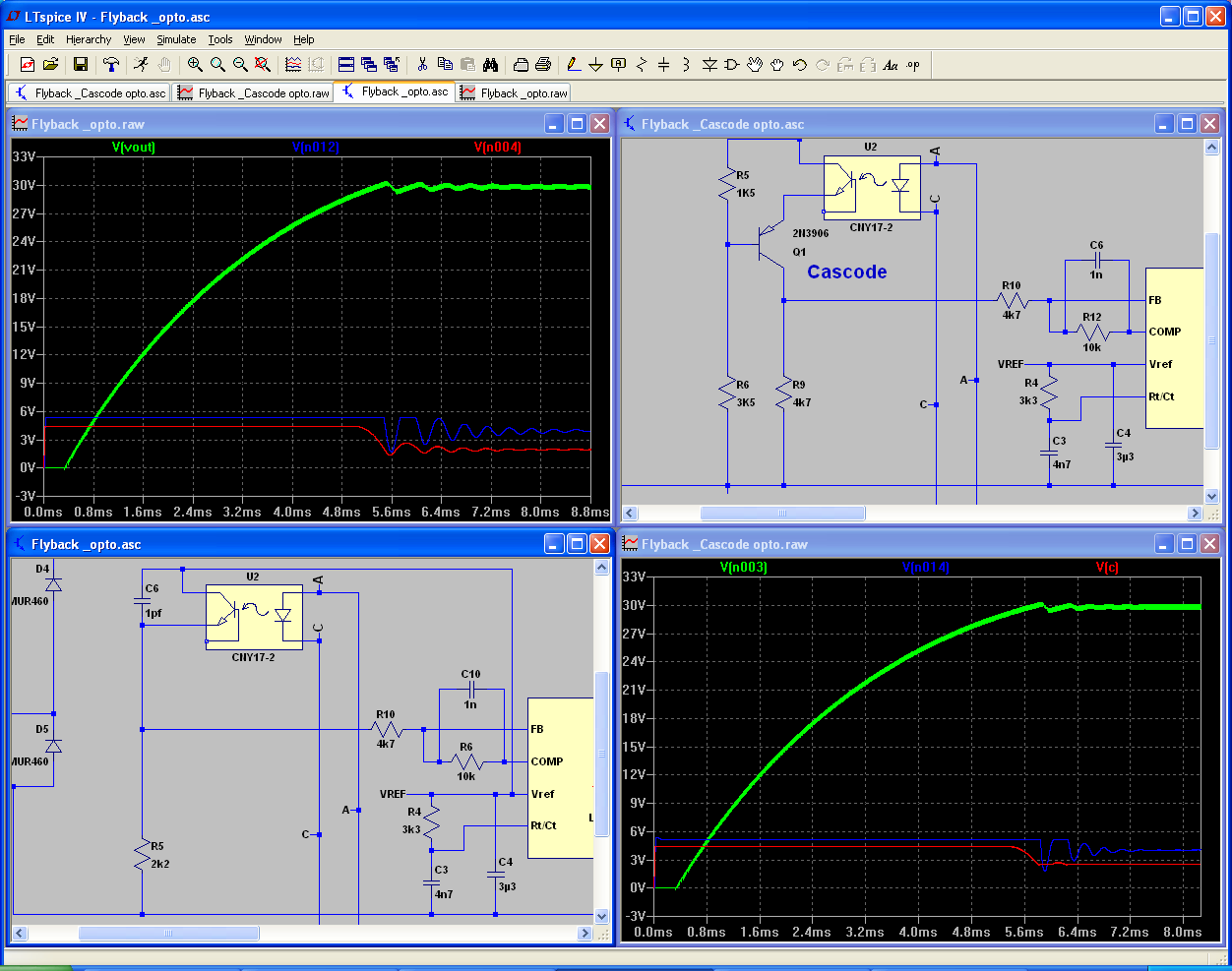

Isolated SMPS with cascoded opto feedback is superior?
Flyback
Please note these two equivalent offline flyback simulations.
-one has cascoded opto feedback , and the other does not.
Note how the non-cascode version has 2V of overshoot on vout at start-up. Due to the lack of a cascode, this overshoot is virtually impossible to get rid of whilst keeping sufficient gain and phase margin. The cascaded version has no overshoot, and achieving this was simple.
Cascodeing is extremely cheap to do...why does everyone not do it?
Schematics and LTspice simulations of offline flybacks given. (one cascode and one no-cascode, but they are the same power level, vin, vout, np/ns, Fsw.)
Comparing apples and oranges:
1)The two output caps are 4.7:1 different.
2)One has a second error amp in the LT1243 with a gain of 2.
3)The "slow one" has a 10nF cap across the 'slow' opto. The fast one has no slow down cap.
4)R15 being different by 3:1 gives me the idea there is a big difference in opto current (translate speed) and a gain difference of about 3 .
5)There are many differences around the first error amp. R9&C5 (lead) and R14&C7&C9.
All the above is blames on 'to cascode or not to cascode'.
...all of these differences had to be put in place because otherwise the non-cascoded feedback network is impossible to stabilise.....this in fact emphasises the great value of casc0ding.
the error amp in the LT1243 is bypassed in both cases
Now they have (almost) the same error amps.
I removed a non functioning op-amp.
Changed a couple of things mostly R11. Needs some work but this is a first try. Looks more stable.
Note V(vout)/10 so the vout and the error amp(s) output can be seen on the same scale.
R10/R12/C6 set the gain and frequency response of the error amp.
....I see what you mean, I totally forgot that in the casc0ded version, I had used the "error amp" internal to the LT1243 as a simple gain stage, as you know, it is not being used as an "error amplifier", the error amplifier is outside the chip, and is done by U3 opamp...but I do see what you mean, you are lumping that gain in with the gain of the error amplifier which is fine.....to be honest, I just wanted to use the internal amplifier in the LT1243 as a unity gain follower, but there was no access to the noninverting pin, so I had to use it as an amplifier....that's why I forgot I had used it as an amplifier.
..its not non functioning, it is as shown on page 16 of this...

Second op-amp: Yours does nothing. I don't think it is the same as Mot's.
Cascode: The point is to have the Vc-e stay constant. (almost) This fights the Miller effect. By adding the transistor the Vce of the opto is probably constant to 50mV. I usually use the error amp in the IC and set the gain to 2 to 10. (there might be a problem at start up, but when running....) If the gain is 10 then the delta voltage across the opto is 1/10 and thus the Miller effect is 1/10 and the speed of the opto is faster. I think by adding gain you can get to the speed of the cascode.
...I think I agree, but without the casc0de, your speed is at the expense of reduced gain and phase margins(?)

You can test the speed of op-amp/opto/amp (or cascode). Just build the error amp section and do a frequency sweep. Plot gain and phase verses frequency. I test the error amps by plotting the gain and phase of just the amps . Break down the power supply into small sections.
looking at the onsemi app note referenced above, surely my connection of that second opamp is just the same as theirs?
Also, regarding comparison of common collector opto connection, and casc0ded opto connection, I ran the following simulation comparing each, and sucessively reduced the output capacitor until one went unstable....the results are dramatic, the common collector configuration goes unstable whereas the casc0ded version rings but the ringing dies away and it goes stable.
These circuits are otherwise exactly the same,and I would conclude from this that the casc0ded optocoupler feedback is superior?

You changed the output cap from 100u to 30u. (the cap was 470u at one point)
This effects the loop greatly. I changed the caps back to 100u and it look much more stable.
Half the loop is inductor (transformer), filter cap and switching frequency.
The other half is the R&C around the two amplifiers. (three is you count the opto)
If you change something in 1/2 the loop you probably should make a correction in the other 1/2.
...Absolutely , that was the whole point of doing it, to creep each of the smps's (both casc0ded and non casc0ded versions) toward instability and see which one goes unstable first.
The change to 30u was made in both versions, and the non casc0ded version couldn't cope with it.
The casc0ded version was clearly superior.
