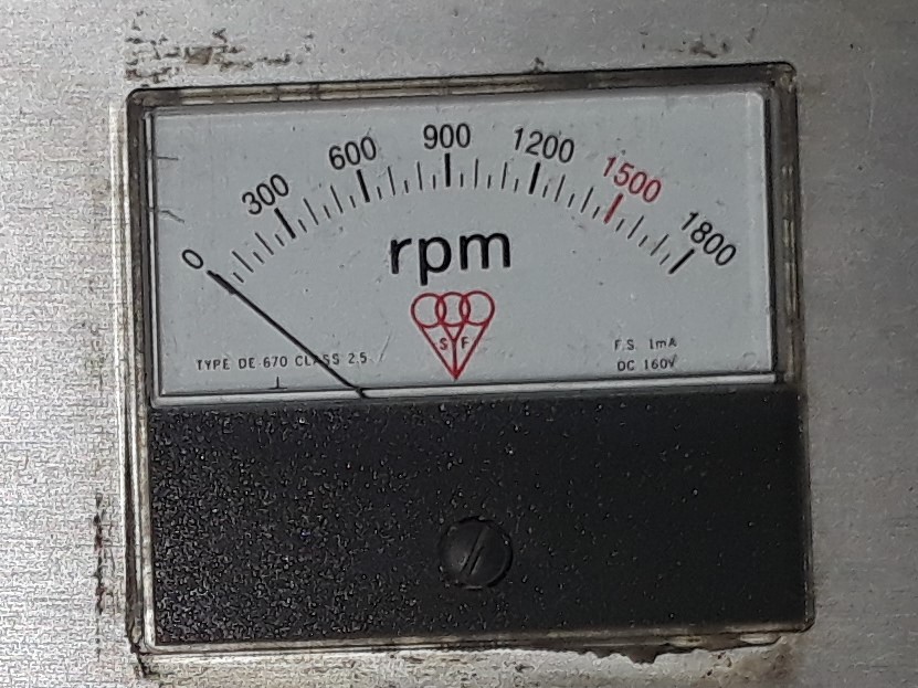

Hi Anyone. Is the attached photo also a 0-160 DC volts voltmeter ? Can I connect the said RPM meter to my DC PWM motor controller which has an output range of 0-175 DC volts? What does the 1mA mean ?

It is basically a 1ma current meter.
I think the meter should draw 1mA, which would correspond to 160V full scale, therefore the coil should have 160kohm resistance, which you can easily verify.
I suggest you start testing it with low voltage and go up, just to be sure that someone for example didn´t change the internal resistor to change the range.
I agree. Meters come in two modes. It might be that it works just fine with 160 volts. BUT. It might just have "160" painted on the face but needs a resistor to make it work right. Start out with a 1.5 volt battery. Like a AA battery. Either the meter will move the smallest amount or it will go beyound full scale.
Read the front of the meter bottom right small print. F.S. = full scale 1ma DC 160v. 175v is more than you need for full scale. To synchronize meter with motor use a series variable timmer resistor.

No. Unless you want to instantly trash the meter.
As MrAI noted:
What that means is that a 1mA current will drive the needle to the 100% position or "1800" on the scale. Unless you know the total resistance of the meter assembly, the max voltage that can be applied in unknown.
Please provide a pic of the back of the meter.
You can start by taking a VOM (Volt-Ohm-Meter), put it to the lowest Ohm(s) mode (checking resistance) and briefly test your meter across its two connections on the back. Also note how that affects the meter's needle movement. Move up a range on the VOM if need be.
Let us know what the resistance is so we can better suggest ideas for what the meter might be used for.
As gary350 pointed out, it's clearly labelled as 1mA 160V - so I would expect it to have an internal resistor.
However, it's so trivial to check it's not worth taking any risks, simply measure it's resistance with a multimeter - 160K means it's a 160V voltmeter, less than 1K means it needs an external resistor.
I agree that it is probably a 1mA meter with 160k resistor making it a 160V meter. Measure the meter resistance. Either it is 160k or about 300 ohms.

I would Recommend you Try with a LOW Voltage first.
Probably Requires an External Resistor for the 160 Volts at 1 mA.
Yes i agree but i would go for the careful test first also.

I have seen meters that are labeled with a voltage but they are really current meters and to get the voltage on the face you must connect the proper resistor in series with the meter. This one is different however because it has got RPM and VOLTAGE on the front.
Some careful testing is strongly recommended.
Everybody seems to be tripping over their feet here. Most DC meter movements are essentially current meters, and can be turned into a voltage meter with an appropriate series resistor. This resistor may be external to the meter (connected in series to the meter terminal) or it may be internal to the meter. You can check if there is an internal resistor by disassembling the meter and removing the meter face, which is usually held in with two tiny screws.

That seems a lot of work, when sticking a multimeter on ohms across the terminals would instantly give you the answer.

My comments were in part because nobody had really explained very clearly that analog meters measure current and that they are made to measure voltage with the addition of a series resistor. Also, that the meter can be scaled to read any desired voltage by adjusting the value of the series resistor.
To complete the discussion, the meter can also be scaled to read any greater current value by adding a shunt resistor across the terminals (assuming it doesn't have an internal resistor making it a voltmeter).
