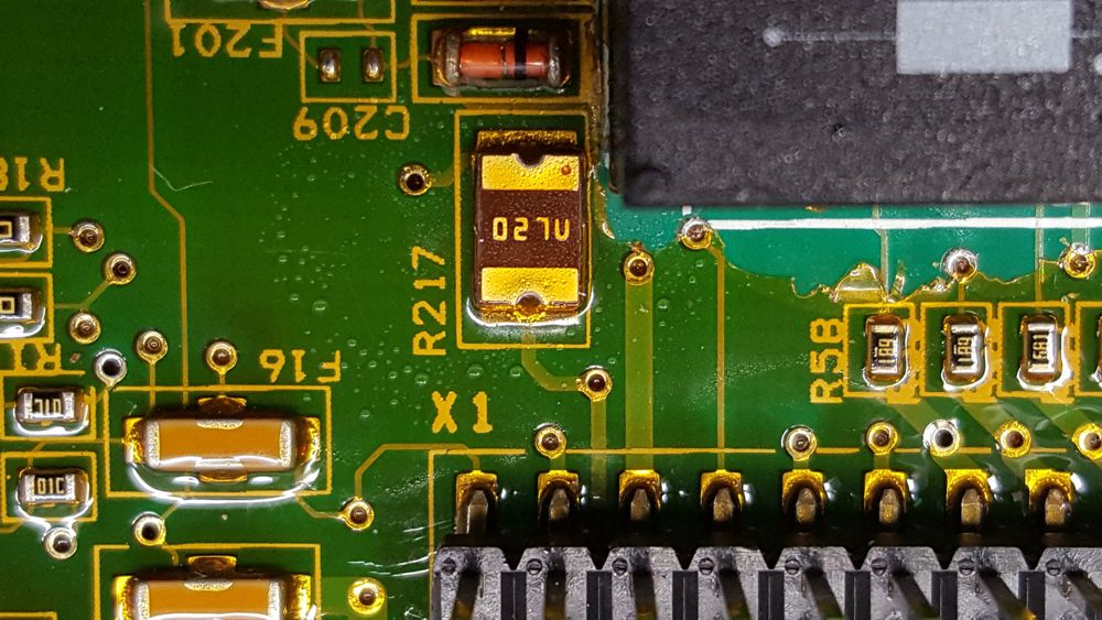

I'm trying to work out the value of an smd resistor that measures strangely.

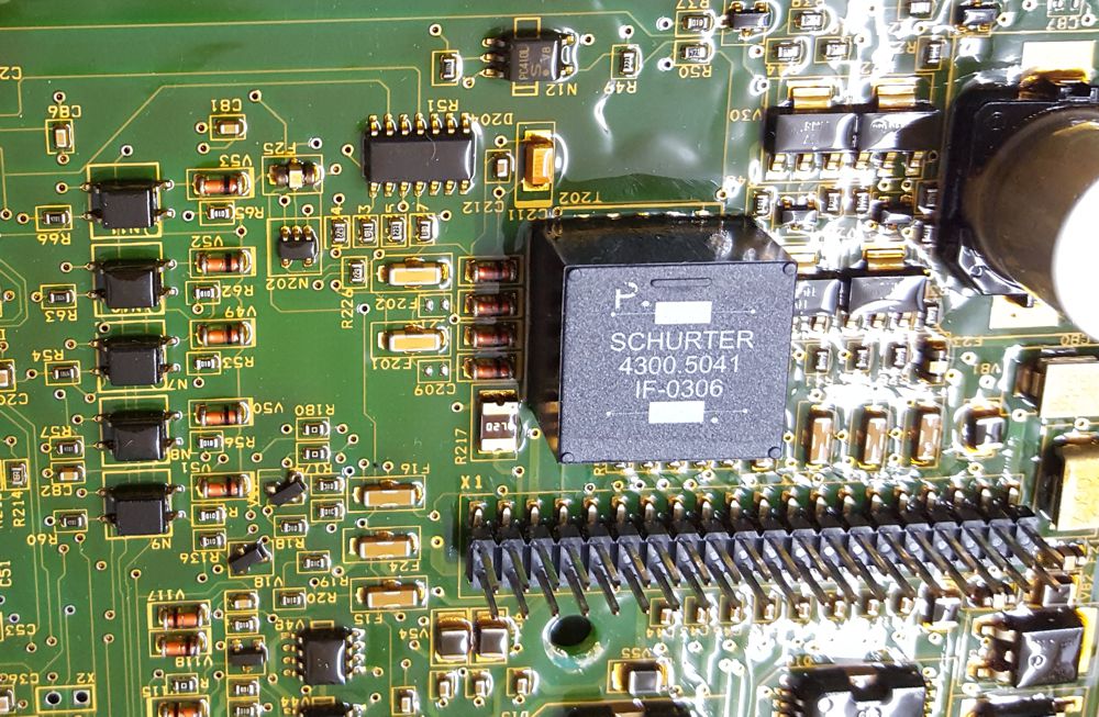

It is in series with the primary winding of a transformer ... Shurter 4300.5041 .. IF-0306 ... that is used as a communications tx.
The resistor is marked 027u ... or upside down nl20 ... and physical size is 3.5mm x 4.95mm.
Not sure why it would need to be so large physically, given its role in the primary of the comms transformer circuit.
Normally I'm very careful to measure components before I disturb too much ... but this time I didn't because the conformal coating is so thick and difficult to penetrate without lots of effort ... and now I'm regretting it.
Inrush limiting perhaps?

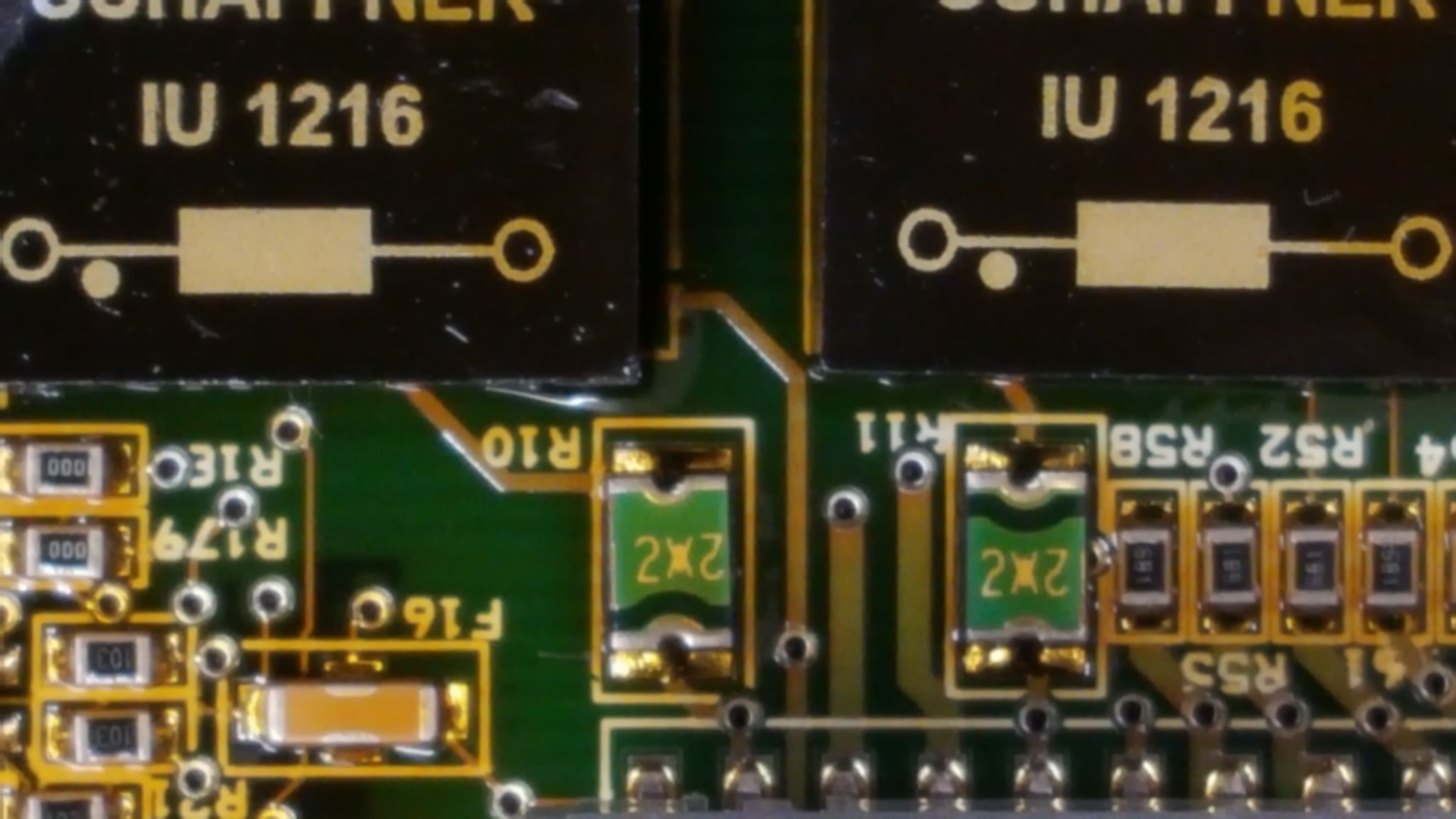

An earlier version of the board uses a similar looking device with some unusual markings ... see pix (for some reason this one has 2 comms channels)

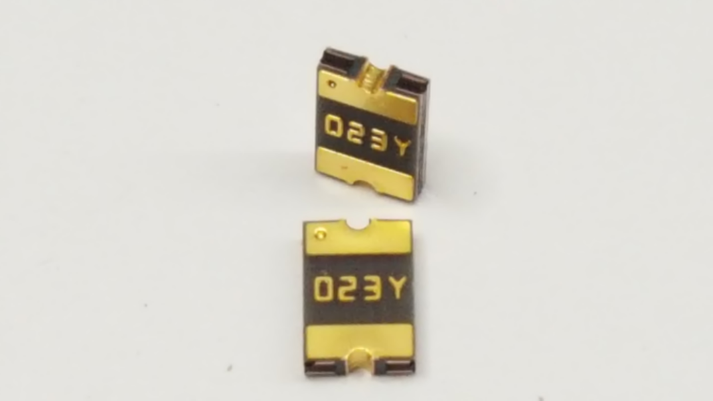

EDIT: So on this board it looks like they are a PPTC Resettable Fuse or Polyswitch judging from the centre character. Possibly the same sort of device in the first picture.
Now I just need to identify a suitable replacement.
It appears to be a PTC fuse, a Bourns MF-MSMF020 which is rated 0.2A
Thank you very much for the pointer and links.
I know I've seen quite a few in my time ... but never actually known what they were ... and never had a faulty one, so never had to think about it. Even this one probably wasn't faulty ... I still put my money on a dry joint on the transformer ... but now I know what it is I'll change it just to be sure.

One thing that kept me off track was seeing the 027 ... and thinking that was a preferred value ... when the 7 was actually the year of manufacture. Oh well, learning all the time.

that notched shape is usually some kind of fuse, so a poly fuse would make sense

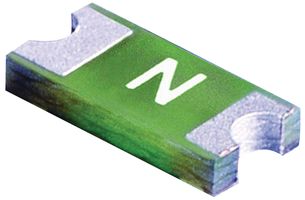

What would be the reason for those notches to be associated with SMT fuses?
maybe it has something to do with the pick and place equipment. i've never seen resistors or caps with notches... it's probably listed in a standardization document somewhere.
actually, i found a close-up picture of a 1206 size fuse, and i think the reason for the notch is that it's made from PCB material, and the notches are actually plated vias. it's very similar to the connections you see on RF modules, where there are notched pads on the edge of the PCB.
-- and / or the notch causes solder to flow into it by capillary action (or just the solder paste squeezing in to it), giving better current distribution / thermal connection through the thickness of the device ??

You can see the end structure from the photo with the (half) vias that unclejed mentioned.
Another unusual point is that they are labled the same on both sides ... and that the marking is in copper ... like the solder pads either end.
In fact on the original, I tinned the label to see if it actually was copper.
