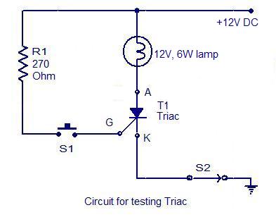

I didn't know there was any other way to test an SCR, other than to use a couple of pushbutton switches, a resistor and a bulb/LED.
The same basic circuit can be used to test BJTs and MOSFETs except the bulb goes of when the switch is released.

Thanks for the link. I had actually found the basic testing circuit but was wondering if there was a reasonably reliable way to test using only meters--it would seem that as always the measurements will only be as good as the meters so I need to measure that too. :)

The simple circuit test indicates that the SCR is just dandy. Pretty neat devices--I've read about them but haven't played with them before.
