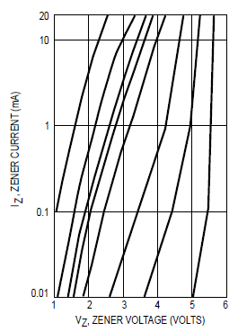

While everyone else was debating what type of op-amp to use, the real question should have been "Is this circuit any use?"
A much better idea would be to pass a known (constant) current through the zener and measure the zener voltage using a DVM.
This project is almost useless when used to measure low voltage zener diodes.
Zener diodes are rated at one current. The current could be high or it could be low depending on the zener diode's part number.
Low voltage zener diodes have horrible voltage regulation that changes a lot with current changes (like a resistor) and it also changes with temperature changes.
Here is a graph of the voltage of some low voltage zener diodes when the current is changed. The graph is from Motorola.
Try to select a "3.3V, 3.6V or 3.9V" zener diode.
