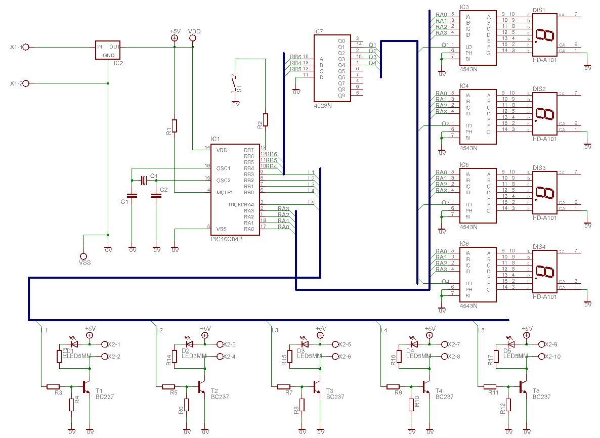

I used the attached circuit to display real time clock via 4 7-segment LED displays. The IC's 4543N are latching 7 segment display drivers. The IC 4028 was used to clock each chip individually with the new data. Unless the 4543 gets the LD pulse, it will not react to the input on the IA to ID pins.
Sorry for the quality of the schematic. Eagle exports these things as massive files and the re-sizing causes some loss in quality.
You can just lower the DPI when you export it...
