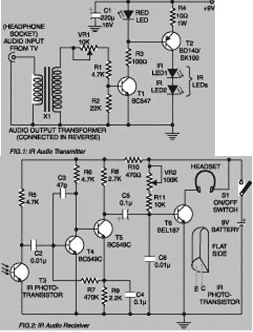

is there a way to make Wireless RF Headphone
err, not RF, but may give you a few ideas.
(don't know where I found this diag, if its copyright, i'm sorry...!)

The infrared circuit is mono, not stereo and uses AM, not FM.
The transmitter must be pointing at the receiver all the time.
The AM will pickup hum from electrical lights.
