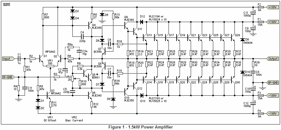

High power car amplifiers use a voltage stepup power supply circuit to provide plus and minus 50V (or more) at 5A (or more) to a high power amplifier circuit.
Unless the amplifier is a very efficient class-D switching circuit then it is linear and uses a lot of power supply power to produce heat. A 500W amplifier might produce 300W of heat so needs 800W from its power supply.
Here is an amplifier that produces 1500 real Watts into 4 ohms. It has 18 output transistors. Its power supply is plus and minus 135VDC at very high current: **broken link removed**
