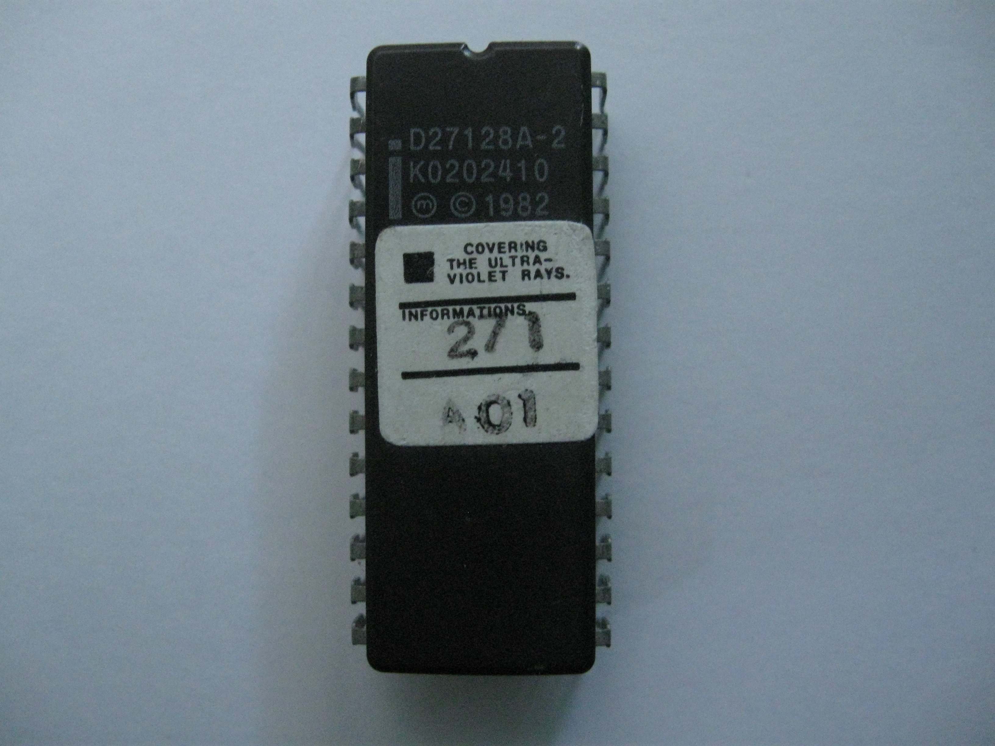

Good day, all!
I recently came across several of these chips:
I googled the number (D27128A-2) and found the datasheet, which says it's a programmable chip. However, my question is would it be possible for a user (me) to program it, and if so, what software would be needed?
Thanks in advance!

Its a 128K bit EPROM, organised as 8 bit wide and 16K byte long
You could make a PC parallel port driven prommer, it requires exposure to UV light [eraser] , the window is hidden under the label.
Eprom Programmer - Base Board
EDIT: Corrected eeprom to eprom
Had a Senior Moment.... "hangs head in shame" , I will go and do 100 push ups in the snow...........:eek:

Bit of a typo Eric?.
It's an EPROM (not an EEPROM) very different things.
As to it's uses - mostly they were used for program storage on old microprocessor systems - they don't have a great deal of use these days.

Don't throw them out, though! You might be able to find someone to buy them who restores old systems (mainly old 8-bit era machines, especially arcade machines). While I have a ton of them already, if you want to get rid of them, PM me (or contact me thru my website), and maybe we could work a paypal exchange (depending on what you want for them).

DerStrom8,
Whilst that chip can be programmed it is not a microcontroller but just an EPROM. You will just be wasting your time making a programmer as the final chip will be of no use. Get some pics and use your time and effort learning how to use them.
Oh, thanks, Mike. I guess I misunderstood what the chip could do.
I'm still planning on getting some PICs anyway, so you probably just saved me a lot of time and money :) Thanks!
