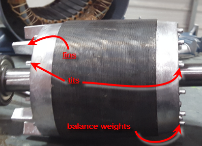

I'm modifying an off-the-shelf 3 phase induction motor to run in an oil filled case.
I want it to have as little fluid resistance as possible. Therefore I want to cut the cooling fins and tits off of it.
I don't believe they will be needed anymore, since the oil will draw heat away from the rotor much more efficiently than air.
I want to chuck it up in the lathe and whack those puppies off, leaving a nice smooth surface.
I'm not too worried about the fins; I'm pretty sure those are not needed.
I'm not too worried about the balance weights; I'm pretty sure I can re-balance the rotor afterwards.

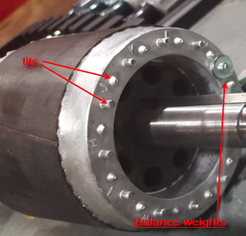

But I'm curious about the tits. Why are they there?
If this rotor had copper bars, I'd be leery about cutting the tits off, as that might sever the weld/solder/whatever between the bar and the end ring.
But I'm 99% sure this is a cast aluminum one-solid-piece squirrel cage. Wikipedia agrees:
A very common structure uses die cast aluminum poured into the rotor after the laminations are stacked.
So that's a solid chunk of aluminum, why the tits? Do they serve any higher purpose than my male tits? Any good reason not to cut them off?

I can only assume they are an extension of the inductor bars, and are there to make electrical connection to the end rings, and also used for riveting over a balance weight?.
The fins are for cooling the rotor.

They are probably risers or part of the mold ejection system from the permanent mold when the fins and shorted rotor bars were pored. If you marked the location of the balance weight, you could dill and tap a hole to reattach it. Or just drill a hole and use a 'pop rivet' to hold it on.
My opinion is go for it, it's the aluminum bars that go through the rotor that count and the end pieces are for shorting them together, I'd say leave as much metal as possible and just take off enough to make it smooth on both ends. How are you going to move the oil around or will there be an oil flow through the motor?
At that depth, the water's probably plenty cool and the oil will be moving so you shouldn't have any heat problems, ought to work just fine.
What's happening at 500ft down? Just looked it up, that's 216 PSI
The fins disturb the air and aid cooling, one thing to note if your going to machine the ally down, there are high currents flowing in the ally itself, the rotor cage is part of a secondary transformer (the rotor itself), the cage is connected together by those lumps of ally each end, if you cut into these a lot resistance will increase and voltage drop will increase reducing torque, that said if you just turn off the lumpy bits current flow will hardly be affected.
Make sure the tits aren't rivet heads (removal of which could seriously weaken the rotor).

Any induction motor I've seen the end plates and shorted bars are cast in one piece, in a permanent molding operation. Not saying they can't be made in more than one piece but think that would be very uncommon.

You can take them off.
They are as others said just remnants of the casting/manufacturing process.
Not uncommon years ago where they were copper bars pressed into the rotor and the bars were connected by copper end caps silver solder on the ends, occasionally a motor running on high load would melt and fling the solder, turn the motor into a high impedance choke!
Max..
I have seen really old motors like that with the copper rotor bars. But that would be a really expensive motor to make in today's world. With little to no advantage over the cast in place aluminum.
