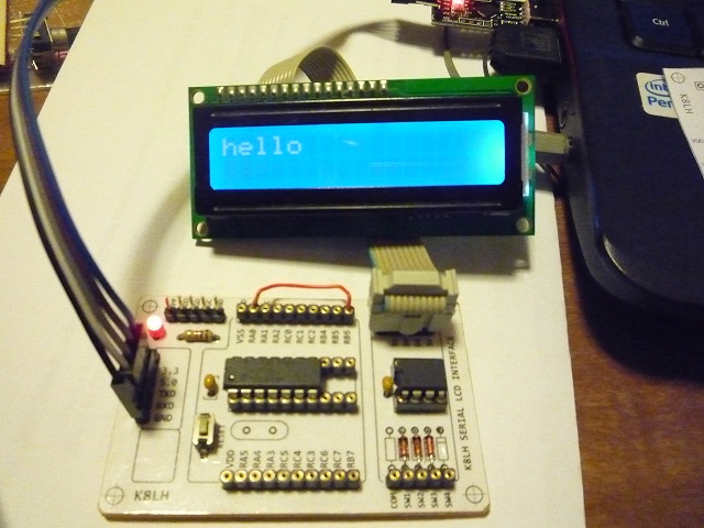

Gentlemen,
Here's firmware for the 12F683 version of the serial LCD backpack. Default baud rate is 57600 and since the firmware automatically initializes the LCD on power up, you need to wait about 50 msecs before sending serial data to it. Send a 0xFE character in front of any "command" character and the firmware will set RS = 0 when it writes the "command" character. Users familiar with the PICBASICPRO "LCDOUT" command are already familiar with this mechanism for setting the LCD RS line to 0.
The circuit makes a very small "backpack" but you can also fit it into a very small space on a project board (see the 8-14-20 proto board below).
I'll try to write up a proper project description, schematic, parts list, etc., and post it in the Projects section in a Forum somewhere in the near future and then post a link to it here on ETO.
Any questions, please ask...
Cheerful regards, Mike
