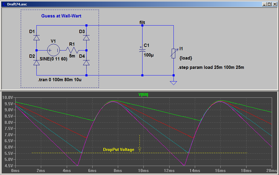

The dropout voltage for your regulator is 0.5V, so the filter capacitor V(filt) must never dip below 5.5V. Here is my best WAG at what is in your wall-wart. This shows that the maximum current that can be supplied by a 100uF is ~75mA @ 60Hz power line frequency. Situation is worse at 50Hz.
Green = 25mA load, Red = 50mA load, ... Violet = 100mA load.
btw: 100uF across the output of the regulator is totally wasted. You would be much better off if you moved it to the input, and used only the recommended 22uF low-voltage one on the output.

So use the minimum required value on the output, and sufficient filtering (not dictated by stability) on the input. I showed that 100uF is marginal for all but minimal output current.
